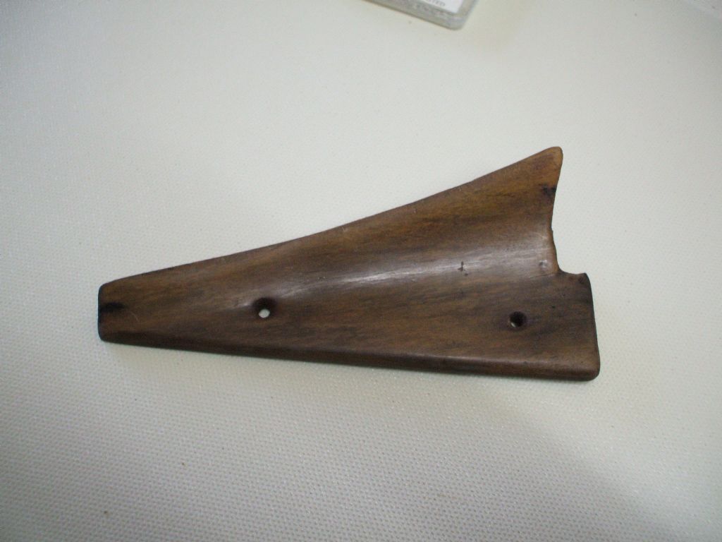

Need help on programing an arc with G codes. I need to make six pieces of trim in wood for a vintage car. The length is 135mm, height is 32mm the radius of the arc is 44mm. Have spent time Googling but not much information on arcs. Not sure on using G18 or G19 codes, I have a small cnc mill using Mach3, attached picture of part to make, any help would be much appreciated.dscf3981.jpg

G18 and G19 seem to be plane selection, you surely need G02/G03 for cutting arcs?
I think JS is probably your man for this one.

HI john
if you are going to machine the rad first and machine every thing else after
it can be done with g19 y,z axis and a bull nose cutter write a subprogram to machine the arc back and forth
using m98 m99 to open and close the subprogram
moving in the x.010" loop it 550 approx. times with an incremental move of .01" using g91 then back to g90
if you have a cad cam system it will churn out thousands line of code
if you have a drawing and size of blank I could write some code for you
hope this helps and not confused you more
Geoff

Can't help at the moment as I'm away from my computer but Geoff has hit the nail on the head in that you need to use the XZ plane with G19

Are you wanting to re-create the surface or just the arc at the top as depicted? or am I missing something!

Seems a bit overkill to me - they could be handmade (like the originals) in less time than it takes to set up CNC. Make a couple of jigs to check the curves.
