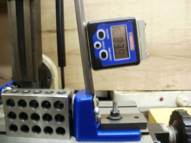

The angle of the pivot seems to be about 6 deg but not a big issue.

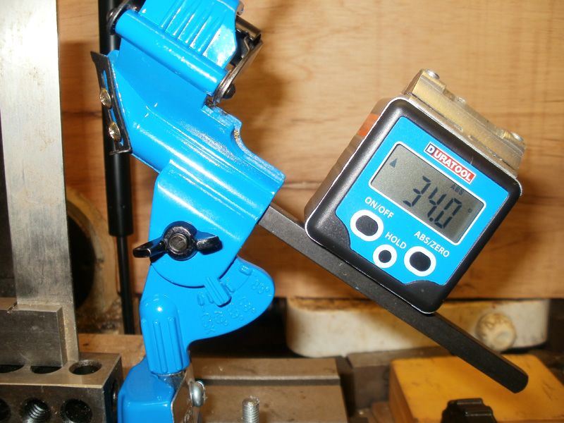

The drill holder sits at 34 deg which I think is going to grind a drill with 112 deg point.

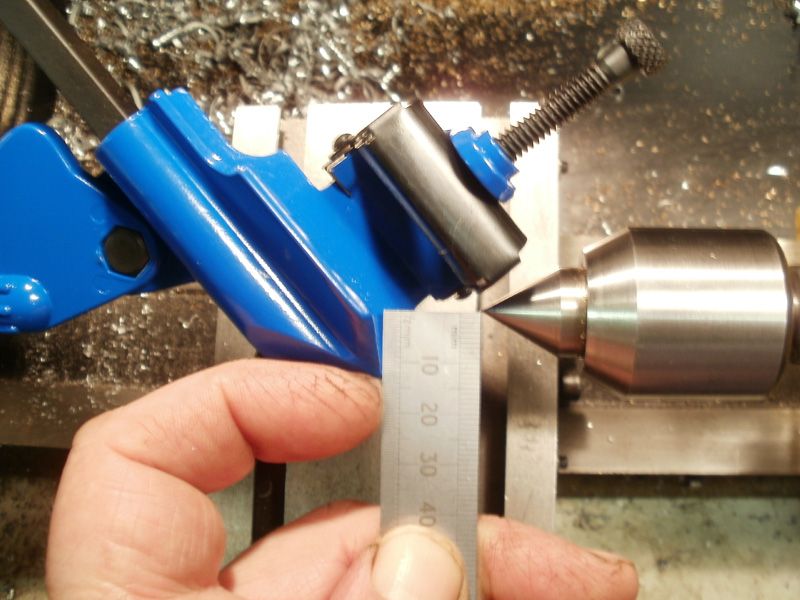

This is where the differences get bigger, the offset between the end of the trough and the centre line of the pivot is around 13mm. The photo has the jig mounted with it's pivot in the lathe chuck and measuring to a tailstock centre.

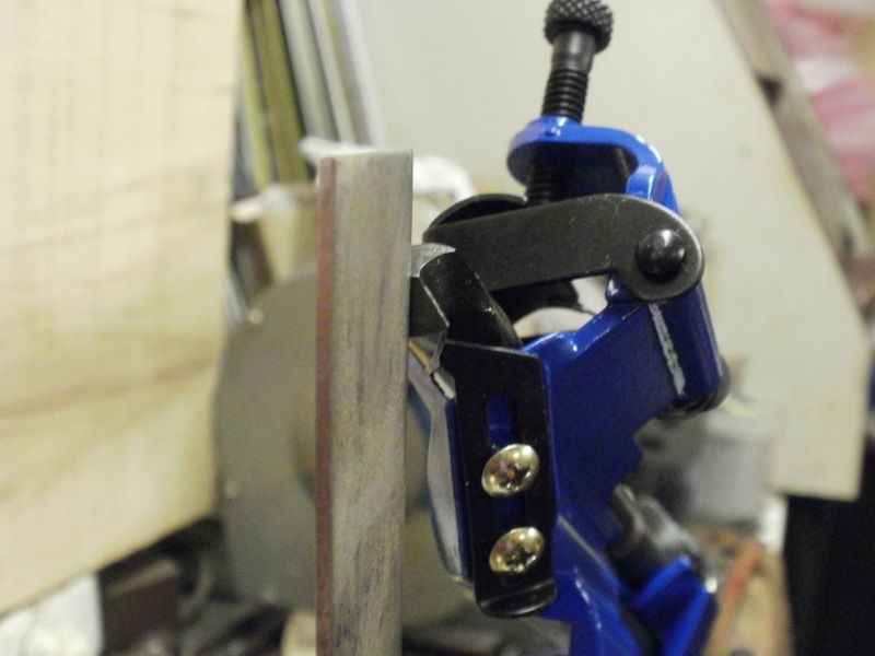

Setting the jig as per the instructions with the drill protruding by half it's diameter as measured from the tip of the lip stop seems to show a slight mis-match in point angle.

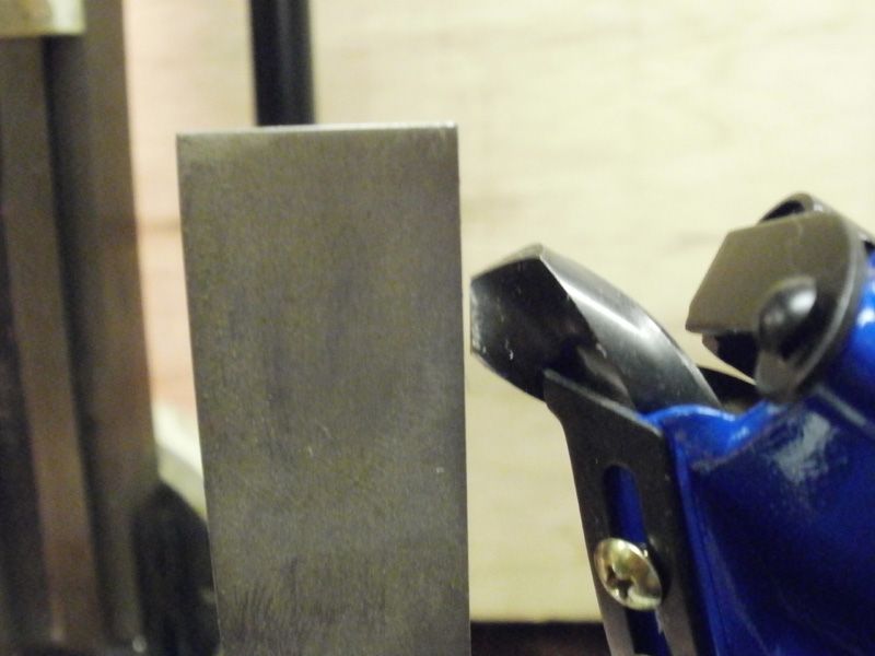

This the jig set up allegedly ready to grind, somehow I expected the cutting edge to be vertical, certainly nothing like the angle shown here.
Some of these differences are easy to fix but the offset difference is huge, any thoughts anybody?
