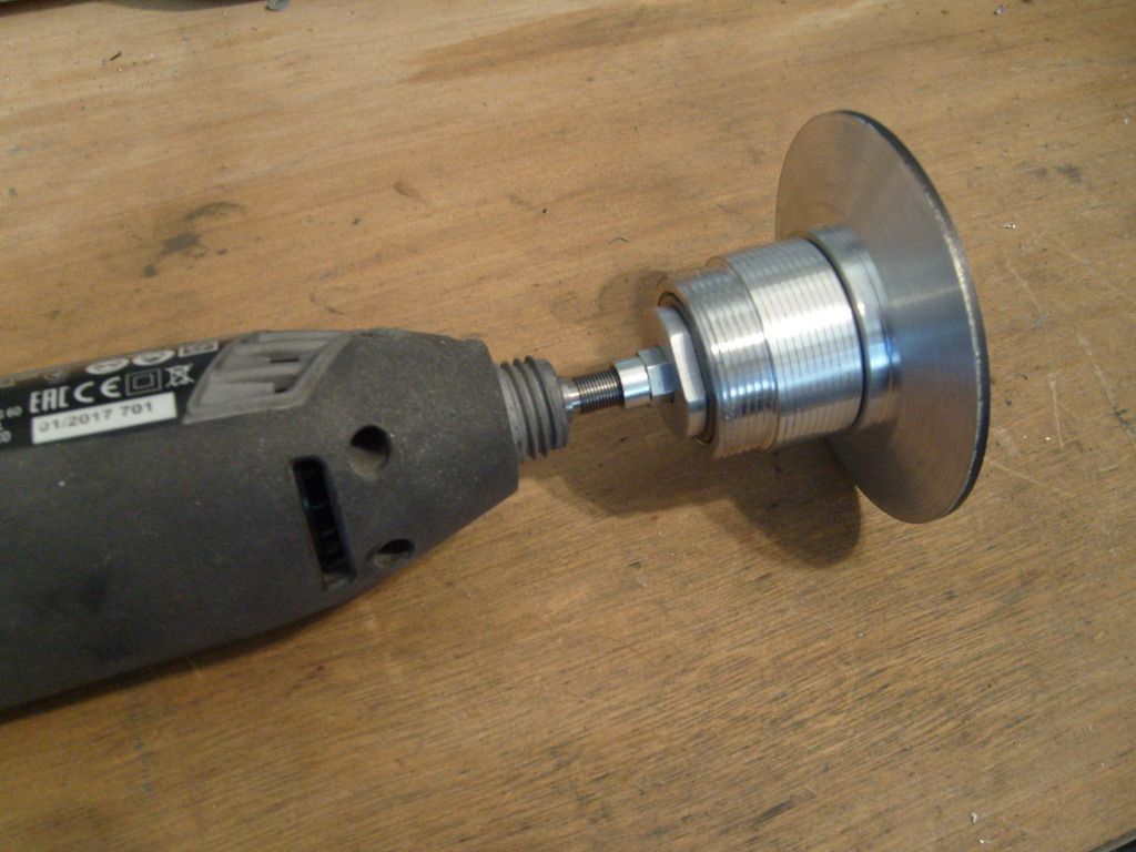

Posted by James Hall 3 on 21/03/2022 14:57:11:
I'm more and more persuaded to go for Huub's solution, the main problem being finding a suitable motor to power it.
I have mounted the disk on a 2 trust bearing axis so the disk is running true without play.
The back of the axis has a hex hole that fits the nut on the dremel.
After a wile, I changed the dremel for the stepper motor that run's very quit.
I threaded the mounting hole of the disk.
The housing fits the dremel thread on one side and the threading of the grinder at the other side.
I choose for trust bearings because the load is only axial.
The parts (without housing)
The parts mounted (without housing)
