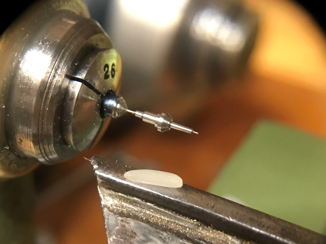

Blued Pivot Steel is a generic term used to cover what is typically a normal carbon steel that has been hardened and then tempered to a dark blue.
This is the 'normal' state that the various shafts with pivots are turned in. The hardened steel tends to take a much better finish than 'soft' and you don't have to worry about heat treat distortion.
This (grain of rice for scale) is turned from blued pivot steel:
probably 2.6mm 'raw' diameter looking at the collet markings. It cuts beautifully with a properly sharp graver.

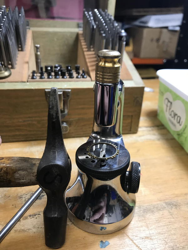

It was then rivetted back into the balance -
need a smaller hammer
So riveting of hardened and tempered steel at watch scales is a 'normal thing.
