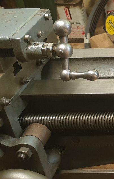

10/05/2020 15:10:24
Thanks Howard, is that what the pair of locknuts are for on mine?
Cheers
Chris.
