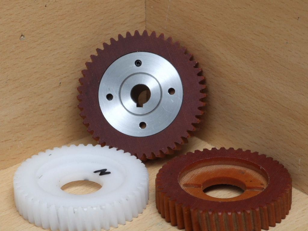

Yesterday was a good day, I managed to cut the Tufnol gears as well as some Delrin ones. When I started out to do this project I did not know I had the Delrin, so when I chanced upon a billet yesterday, I thought why not make a couple more spares.
Above is the finished assembly and some spares, note the M3 Grub screw to lock the Ring Nut at 12 o'clock. I find clicking on the photo gives a better view.
