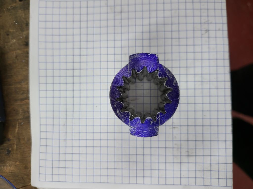

So I lost the spindle drive on my Omnimill. Stripped the pulley section off to find a worn out drive dog that doesnt exist on the parts list I have.
The drivre dog lives in the inside of the top pulley assembly.
Decided to have a go at making a new one from aluminium so made up a broaching bar and ground down a bit of HSS to match the spline shape. Made up a clamp of sorts to prevent the spindle from turning.
The hole on the aluminium plate was drilled off centre to allow the edges to fit into the splines and stop the shaft from rotating to allow mw to cut the new splines.
Carried on and cut the drive dog not realising that the cutting tool was slightly off square to the drive dog so the splines are a bit wonky but it still fits and works ok.
Cut the groove in the drive dog to allow it to be held by the same circlip that holds the bearing cover plate in place.
Greased up the bearings while it was apart and fitted the new drive dog and all is well again. First spline I`ve ever cut and happy that it works besides being a bit off.
