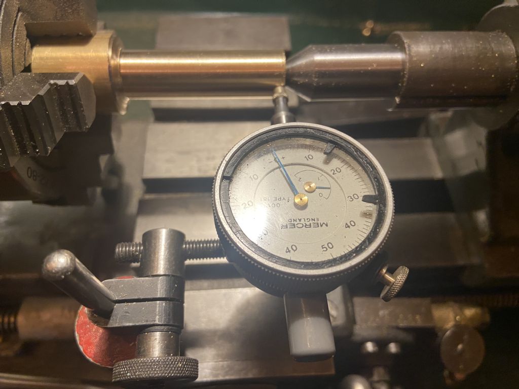

03/10/2021 14:42:32
Posted by Steve355 on 03/10/2021 14:38:44:
Thanks for all the comments
when I remeasured my work this morning the taper was back 😢 no idea how but it clearly is
So I thought I would try what several have suggested and turn a new piece of brass rod without tail support and try shimming the tail end to get it parallel. So I did that…
my first measurement was 935 at the headstock and 961 at the far end. I added shims tightened it back up and took several more cuts and measurements.
now I have quite a lot of shim (about 030) and my level (love it or hate it) indicates a significant amount of twist that wasn’t there before. Headstock:
tailstock:
shims :
my latest measurement is 908 at the headstock end and 920 at the tail end, so quite a lot better but nothing like close enough. I am starting to think this is nonsense, because I seem to be adding twist to try to reduce taper. In addition the finish is bad at the far end of the bar, which is what one would expect I believe, and probably enough to account for the taper.
basically it doesn’t seem to be working. I’m worried too I could damage the lathe.
arghhhh!
Steve

03/10/2021 10:12:02
Posted by Steve355 on 02/10/2021 22:17:10:
Ok, you are right, it’s all me. I did that and it’s very close to parallel - about 1 thou out. I checked again with the micrometer and got the about .5 thou. Luckily this is the “beginners” forum so I am allowed to be an idiot.
Why did it give me an incorrect reading on the other side then?
Hard to describe in words coherently but easy enough to show.
Your dial is not actually measuring taper as such, I mean it MIGHT be or there might be a taper when it's showing no movement. To measure taper with a dial you'd use a comparator stand.
With the dial on the front and mounted on the saddle it is following the same path that the tool took when it did the cutting. It should therefore give the same reading all along the length. If there is any wear or twist in the bed then where the tool was caused to move away from the centreline of the part, so would the dial point. It would show no change.
With the dial on the opposite side of the part if there was wear or twist causing the tool to move away from the centreline of the part then the same wear or twist would cause the dial to move TOWARDS the centreline which would give a rising reading.
02/10/2021 21:10:42
Put the mag base for the dial gauge on the front of the saddle and do your measurement again. That way the dial gauge will be following the path of the tool and should read zero all the way.
That gauge setup is a poor way to check for taper if that's what you're doing Steve. You should be using a micrometer to take measurements at each end of your cylinder. The dial gauge reading can be affected by twist or wear in the bedway.

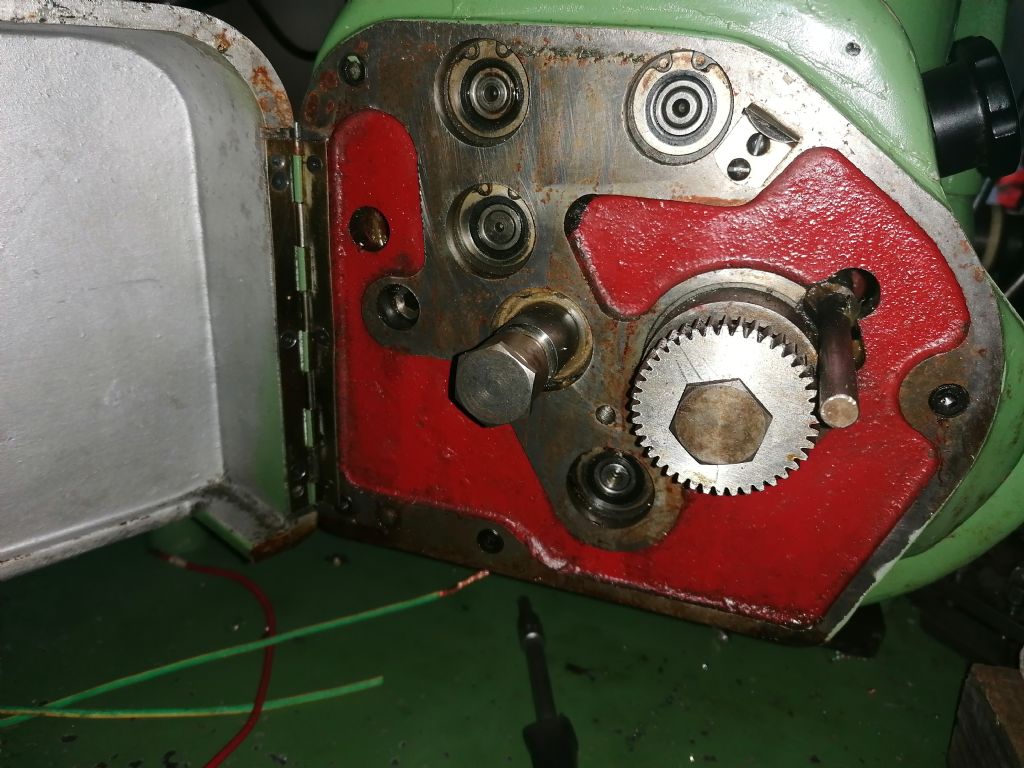

30/09/2021 18:08:06
Posted by Fernando Abad on 30/09/2021 10:45:01:
Hi, according to the picture, do you think that something is missing? I have made some test threads and I think they are metric, but I see pictures of other Hardinge and I see that they have more gears, on the lathe they did not deliver more gears, are more gears necessary? greetings.img_20210930_102529.jpg
Yes you are missing the quadrant that holds the extra gears. It may be that it never had one. The rod you can see poking through is the interlock that prevents you from engaging the extra gears if the gearbox has a feed selected. If you move the lever to the AUS (OUT) position you'll see that the rod sits below flush which would allow the quadrant to move (if it had one).
You can cut all of the metric pitches on the chart as the machine sits right now. The quadrant is only required if you want to cut any other pitch than what's on the chart.
