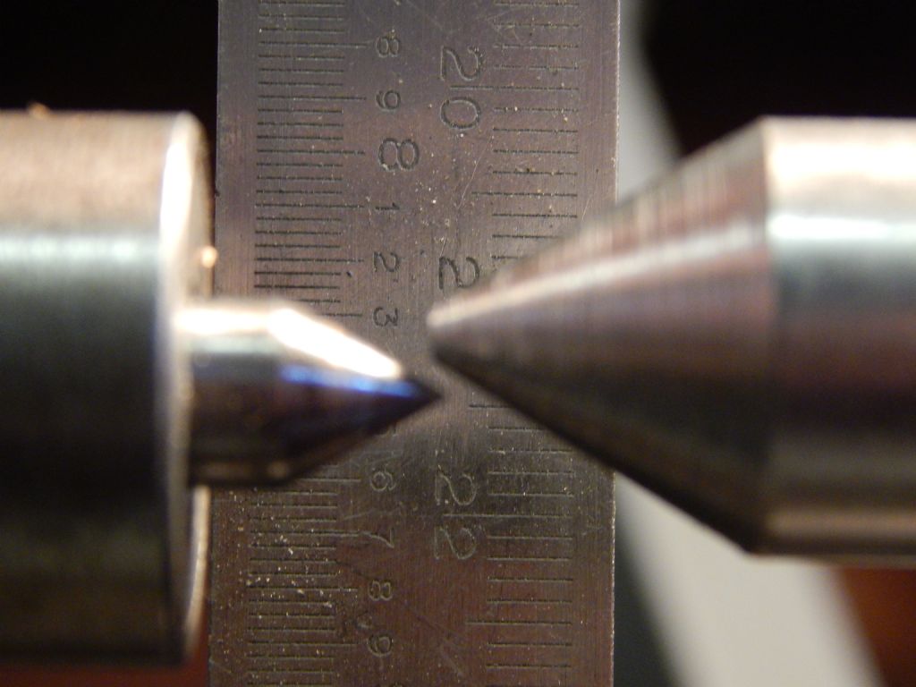

Fixed my ML10 mount onto the bottom Drummond saddle not very elegant yet but suffices to take up the distance giving me a new amount .
Bolted down top part for a proper test in difernece of height
Now have a smaller amount to remove
New reading
Thread: what width bed is an ml10 please
19/10/2016 20:45:58
I put a ruler next to a sharper dead centre and found it was 2.75 lower this gives an eventual height for he conversion of and final height would be 15.75mm.
final drop is2.75 after removing 3mm from bottom

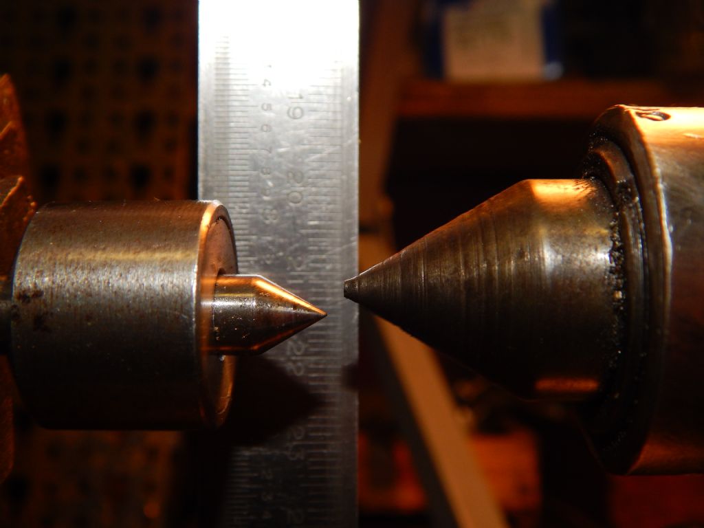

Here is a ruler behind them in focus on the ruler then on tips
In focus on ruler
In focus on tips

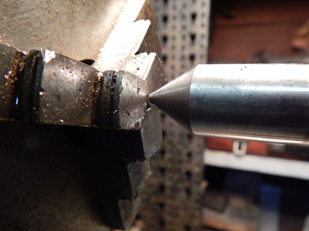

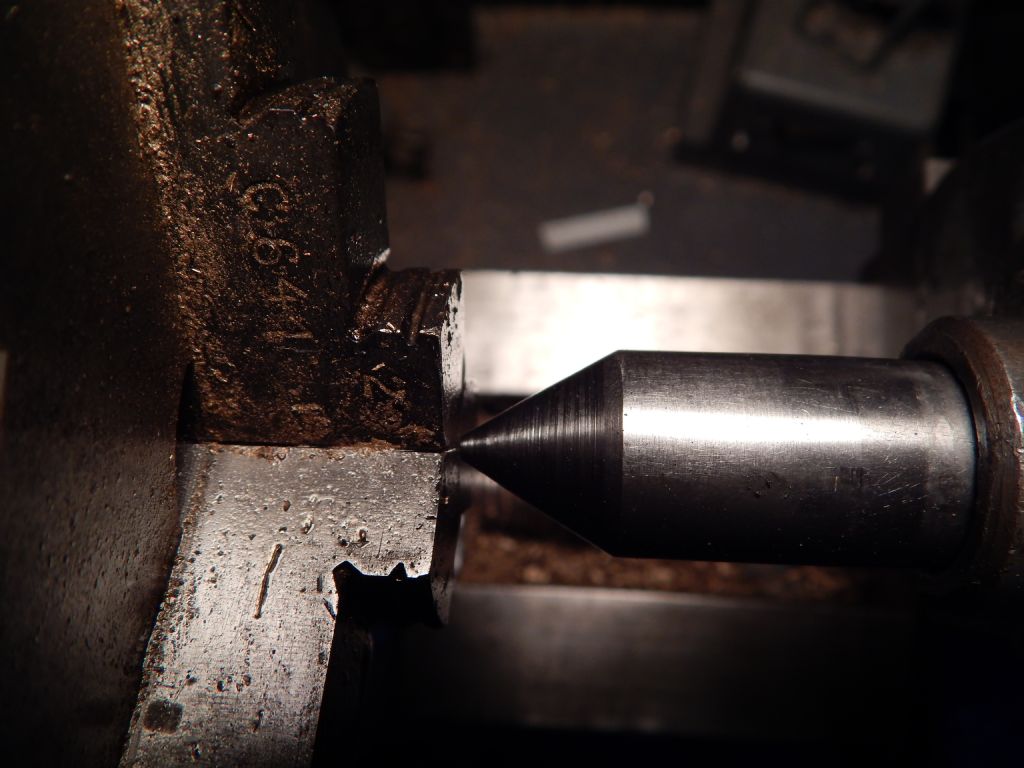

Did a bit more to this got horizontal in the ball park and just vertical is out now . Will remove 1mm and see again
Getting closer only out in horizontal now
horizontal is great adjusts up nicely
Still have some material to remove . Going to remove 1mm next and then  try again
MN

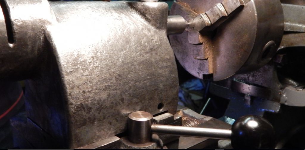

First try on seems t need some adjusting.jpgo
First try still needs adjustment
10/10/2016 20:11:13
Here is first try much more to cut down
first trial to see how it will fit
10/10/2016 20:10:03
Some cutting down today much more to cut around 5mm to get centres same as mt1 tailpiece. Intend to take some from top and some from bottom.
first cut removal of the lower parts
flat bottomed now

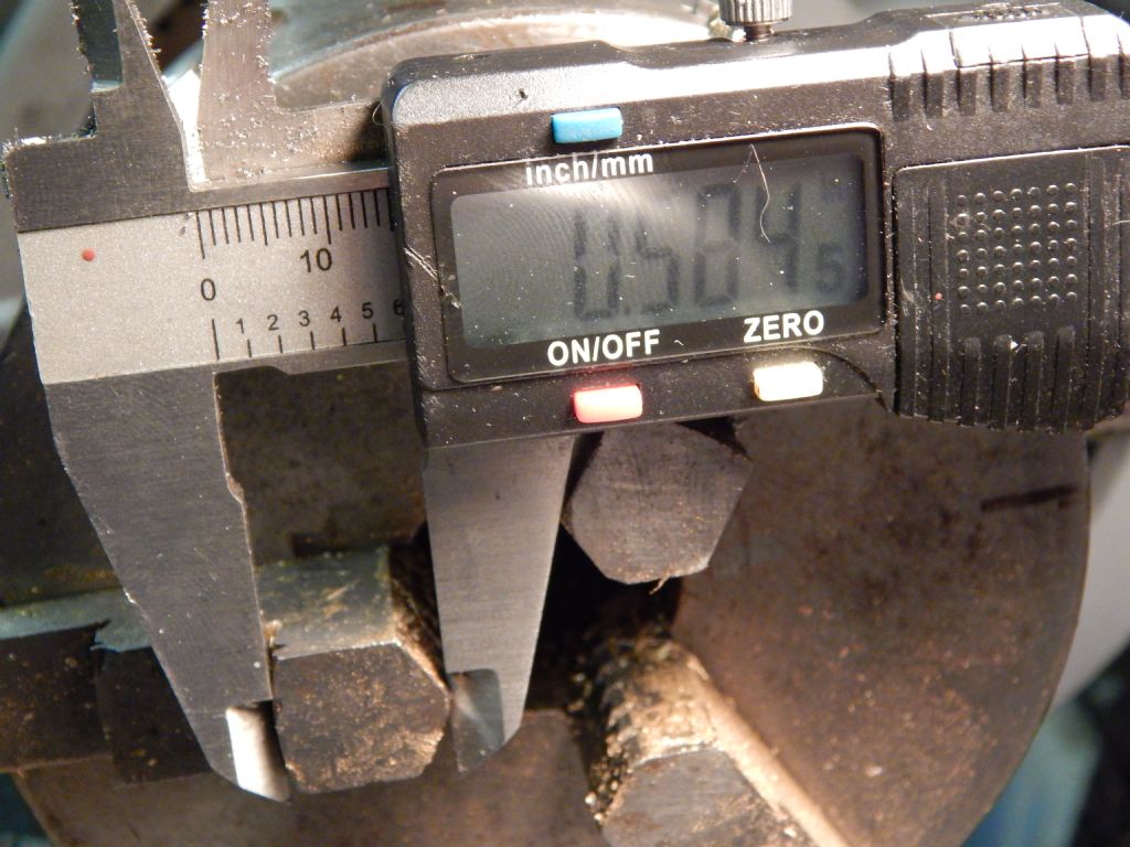

chuck tooth
Mocked up on tailstock saddle to measure vertical displacement
Try to see if the top was put on teh saddle where the vertical centre came
Difference from Drummond tailstock saddle to center calculation
Chuck Jaw height: 0.5845”
Tail Centre Dia: 0.1135”
Chuck Hole ½ Dia: .039/2”
Total .7175"
First cut will be .08” leaving difference from block to correct height .0825" to remove if all goes well. Does this seem right?
