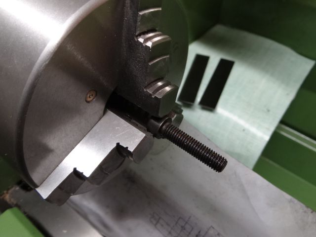

05/09/2016 12:03:44
Posted by Jim O'Connell 1 on 05/09/2016 09:12:25:
Posted by SillyOldDuffer on 02/09/2016 16:38:08:
Posted by Jim O'Connell 1 on 01/09/2016 19:41:52:
What I want to do is put a spring recess 10mm wide by 1mm deep in the plug that screws down on the spring.
I have the 2 flute end mill to do the job. Just looking for a quick way to center the plug in the chuck or whatever.
Have a good few to do!!!
Hi Jim,
Is this what you are trying to produce? If so, how deep in mm is the head that needs to be gripped?
Ta,
Yes. This is what I want to do. The head of the plug is 4mm X 25mm and the treaded part is 15mm X 20mm long
Hi Jim,
I'm at the inexperienced end of the spectrum so I'll be interested to see what the experts make of this.
I'd use a bar across the body of the chuck to provide a flat surface against which the top of your plug can be pressed to get it at a right angle to the ways.
Then press the plug against the flat provided by the bar near the tip of the chuck and tighten the jaws.
I tap the bar out because of the trouble it will cause if it comes loose with the lathe turning!
Probably not the best way of doing the job but it might be 'good enough'.
I used two parallels as the bar only because they happened to be the right size to suit the bolt used as my example. Anything that provides a flat face to locate the work whilst allowing the jaws to be tightened on the job will do.
Cheers,
