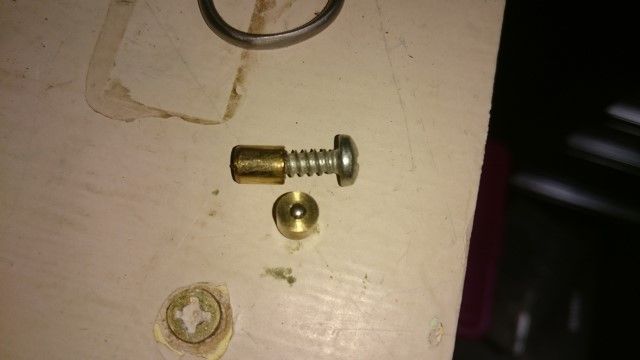

16/01/2017 09:49:58
Old and new Push Button oiler.
I screwed a self tapper in to the old one and used a claw hammer to lever it out.

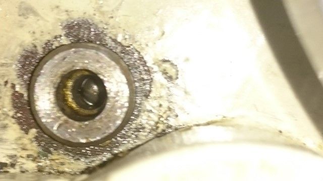

16/01/2017 09:47:29
Here is the stuck ball I think the silver/shiny bit on the L/H is the spring.

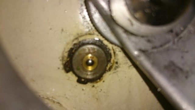

16/01/2017 09:45:24
Sorry about being blurred trying to get a close up, but the is what it should look like.
15/01/2017 08:05:20
One of the Push Button oilers ball is stuck in my lathe.
I have pulled the brass housing out, but the ball is stuck about 25 mm in.
I tried getting a magnetised rod to try and pull it out, didn't work.
Is there any way to get it out with out pulling the carriage to bits.
The lathe is a Steelmaster SM-0920V 9 X 20 ,
PS How do I post a photo?
