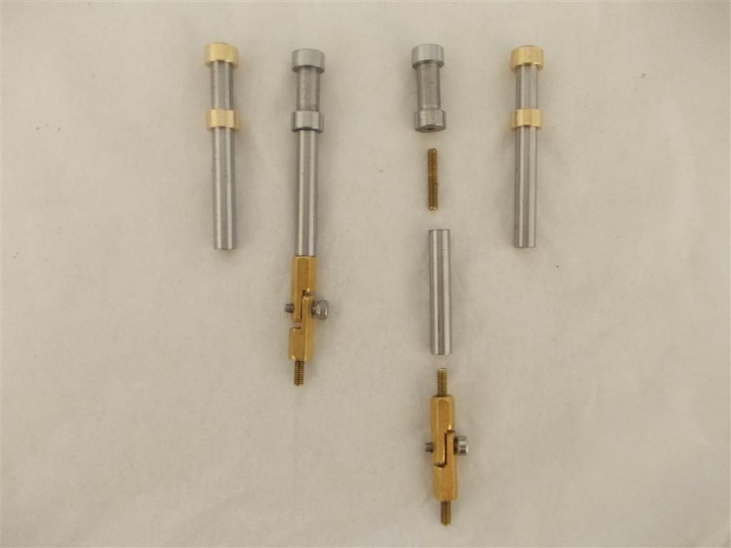

18/10/2016 08:08:46
I was not totally happy with my idea for the control valve so in case the retaining compound does not hold I have come up with a plan B. The control valve has been made in two parts using 6mm silver steel and 4mm silver steel joined together with M2 threaded brass rod which will be held in place with Loctite 222 (low strength). The only turning I had to do was reducing part of the 6mm shaft down to 4mm. I used the flat edged parting tool for this, taking small 0.05mm cuts while passing it back and forwards between the 6mm sections.
Drilling and tapping took longer than expected due to rubbish drill bits breaking ! I hade to remake the parts a few times. I bought some good quality 1/6'' (1.59mm) drill bits today from NQ fasteners here in Cairns. They only had two in stock but it was enough to get me out of trouble. I will join everything together tomorrow. I have screwed one together on the photo and left one in parts so you can see how it fits together. I think somebody suggested this idea earlier...many thanks.
UPDATE : the fly cutter has gone missing and nobody knows where it is at this stage. It left Melbourne 16 days ago. I am starting to think about making some sort of jig and filing the cylinder flat by hand.
Edited By Brian John on 18/10/2016 08:10:49
Edited By Brian John on 18/10/2016 08:14:13
