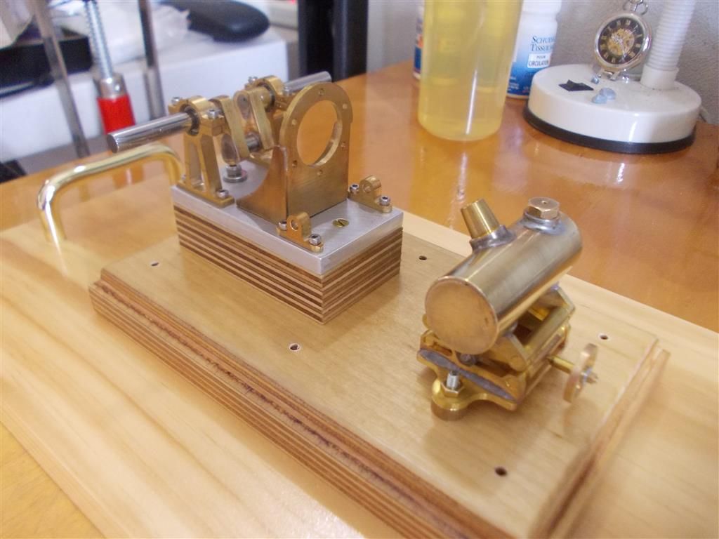

After much fiddling about and trying many things, I have realised that this burner as built cannot be fitted with horizontal adjustment. Any horizontal adjustment would mean raising it higher and even 4mm higher places it too high. I think the vertical adjustment on this is totally superfluous : at its lowest setting is where it is supposed to be so why raise it higher ?
Having ascertained that the burner must be fitted flat to the wooden base, then that means the adjustment wheel must hang over the edge and that means bringing the engine base in closer. The diagrams show the engine base to be right on the edge at the other end but that would mean it would be about 20mm from the burner flame...not very useful ! The engine base must be 18mm from the edge of the larger wooden base and this should put it in the correct place (hopefully). I have had to take the whole thing apart to redrill two more holes so I can shift the engine base.
NOTE 1 : the instructions do not give any measurements for placement of the burner or engine on the wooden base.
NOTE 2 : perhaps reducing the length of the wick nozzle would allow for some vertical adjustment. I might try that if I build another of these engines.

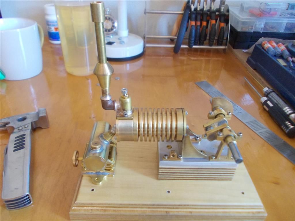

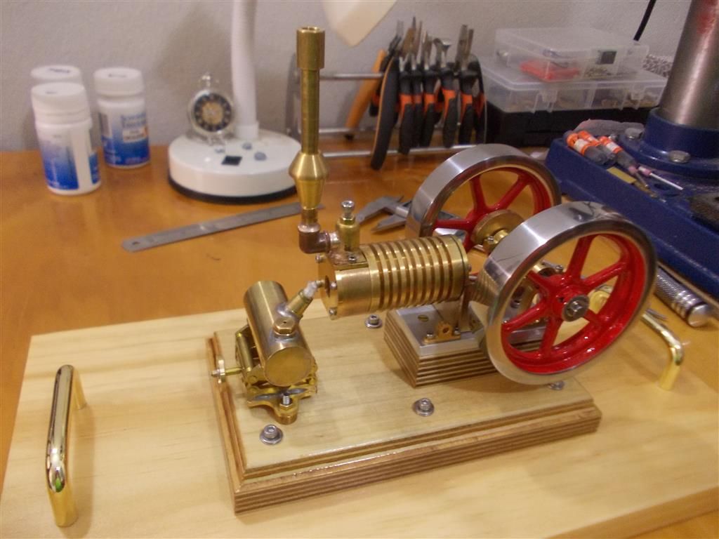

I got tired of waiting for those replacement parts from Germany. I am not sure what has happened there as they are usually very quick but I have decided to assemble the engine without the slide valves just to see how it all fits together at this point. There is still a slight tight spot between the piston and cylinder but I am hoping this will work itself out ; the two large flywheels provide a lot of inertia and the engine rolls over quite readily.
If anybody is building this engine now then be warned that the diameter of the spigot on the main cylinder (part 20) is given as 20mm but this is too big for the hole in the cylinder bracket (part 19). I had to reduce it down to 19.4mm to get it to fit. Even at this reduced diameter the spigot was still too big for the supplied gasket which had to be trimmed with a scalpel blade in order to fit it between the cylinder and the cylinder bracket.
It does make me wonder why there is a gasket here at all ? Is it to reduce the heat transferring to the cylinder bracket ? I only soft soldered the cylinder bracket ; I think I should have hard soldered it. I will do that when the new parts arrive. The instructions do not say anything about it even though for all other parts they are very specific regarding soft or hard solder being required..
I have not fixed the burner in place yet. I am still thinking how I can install some sort of horizontal adjustment.

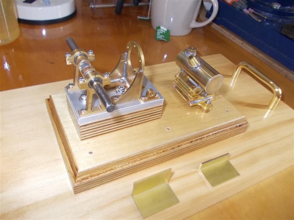

I am still waiting for the replacement slide valves to arrive (accident with silver soldering) and the flywheels are being painted now (one more coat of Killrust red). All other parts are now ready for assembly. The diagram on the instructions shows the block on which the engine is mounted to be right at the end of the wooden base but this is not correct as then it would be too far from the burner. I have moved it in a bit but I still have to bring the burner in to meet it. To do this I have had to mount the burner on 4mm barrel washers otherwise the height adjustment wheel would not have sufficient clearance. The original design calls for it to hang over the edge of the wooden base.
I do like the idea of some sort of horizontal adjustment for the meths burner. I am open to suggestions as to how I can do that. I am thinking of two brass U shape rails and the burner can be slid along on this ?
I also do not like the cylinder bracket arrangement which relies on soft solder to support everything. It was pointed out to me earlier that the fillets are not doing much to support the bracket. The brass is not very thick so I am not confident of the strength of this part. I am thinking of making something else out of brass angle which you can see already cut sitting on the wooden base. I have also ordered replacements parts for this so I will experiment a bit when they arrive.
NOTE : shim washers, barrels washers...what is the correct term ? I tried to buy some here in Cairns and nobody even knew what I was talking about so I ended up making them myself.
