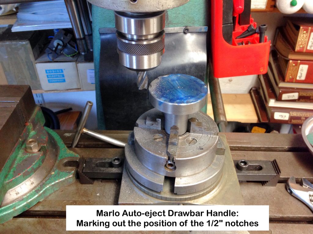

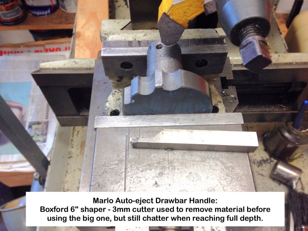

13/12/2014 16:45:17
Posted by Bob Brown 1 on 13/12/2014 14:20:06:
If I was doing that job I would use a round nose (ball) cutter in the mill
Edited By Bob Brown 1 on 13/12/2014 14:21:53
"Damn and blast" as my old man was fond of saying when something obvious was pointed out.
I have one of those, as well as the Excel filing machine that has been giving me verbals for not remembering what it's used for.
May have already made too much of a whatsits so far, but will see tomorrow.

13/12/2014 14:01:56
Need help from the Collective please.
Last stage to finish the Auto-eject drawbar, made from the Hemingway kit.
I need to machine the half round 1/2" notches in/around the periphery of the handle.
Any ideas please.
This set-up for marking them out is just a little light weight for either a slot drill or milling cutter:

This on the Boxford 6" just produces such monumental chatter, it feels as if the shaper will shake itself to pieces:
Marlo A3 Milling Machine Drawbar
Have used the 3mm cutter to remove material first:
