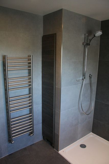

Nice tiles!
I put the towel rail up at the weekend:
Edited By jaCK Hobson on 28/04/2016 08:17:08
