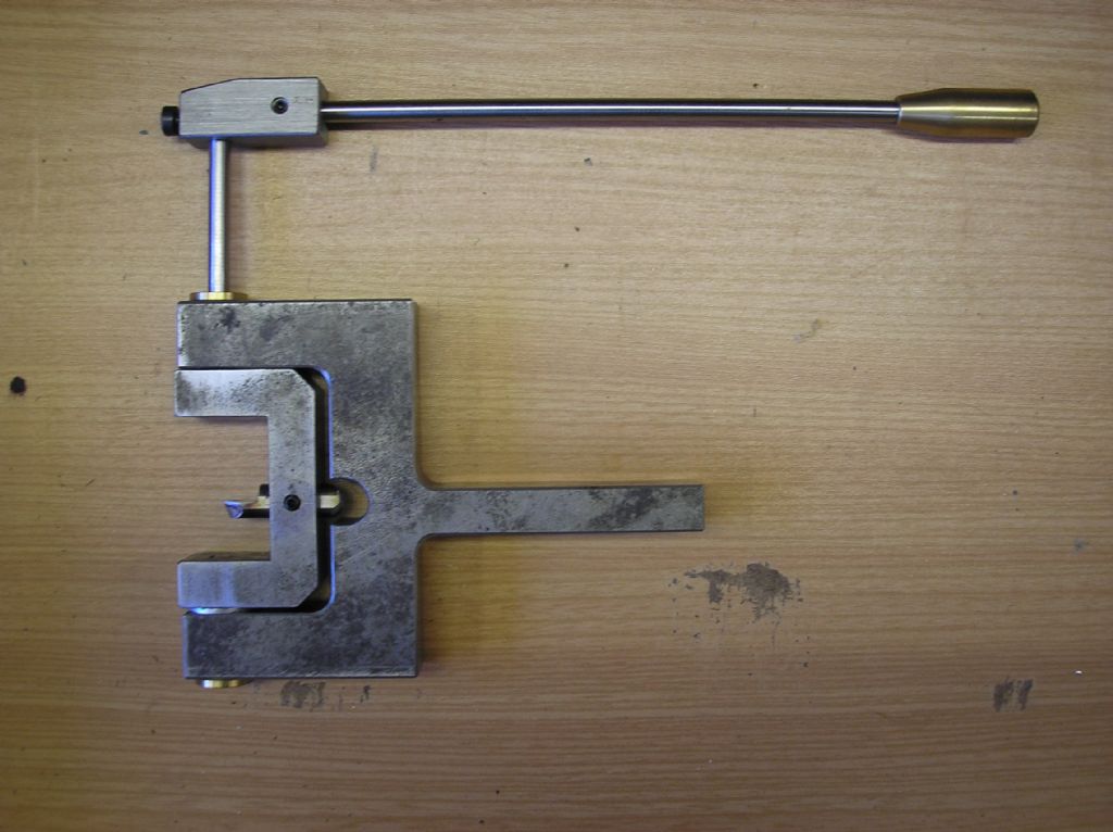

Radius Dresser
Made from 3/4" thick mild steel. Fits straight into my ML7 and can cut a 32mm dia ball if required. 10mm dia HSS tool at present but I may go to a carbide one later. All moving parts have phosphour bronze bushes.
