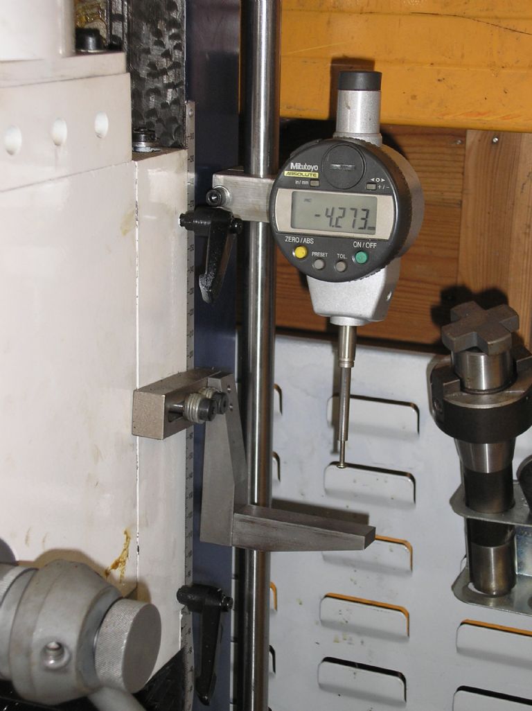

Digital Drop Clockl for head adjustment
adjustable sliding bracket on 16mm shaft, fitted to the column of my mill with drop clock fitted to it. This can be used in conjunction with the stepped bracket I have fitted to the side of the head of the mill. This enables fine adjustment if I am milling or fly cutting. It helps save the quill bearings too.
