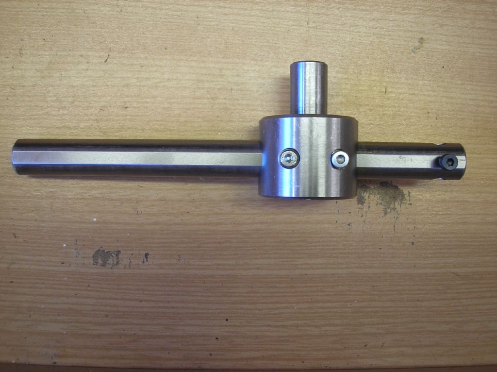

Centre Finder
16mm stem fits in 16mm collet, 1/4" hole in adjustable 16mm shaft with 5mm wide flat for locking screws holds the DTI. Rangesfrom 30mm dia to 300mm dia. Also used for checking that the mill head is true to the table.
