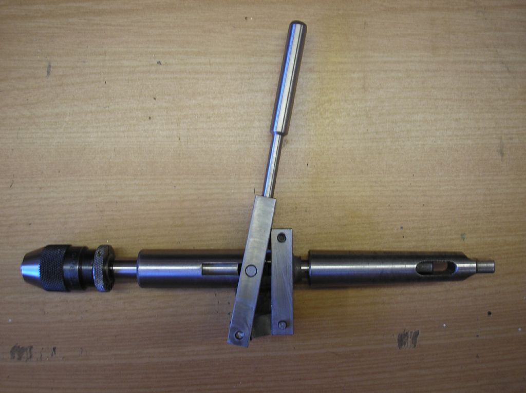

Sensitive/ Pusher Chuck
Albrecht chuck 0 - 3mm, Modified 1 - 2 morse taper adaptor. Shaft ground true to chuck. This allows me to drill very small holes very accurately
