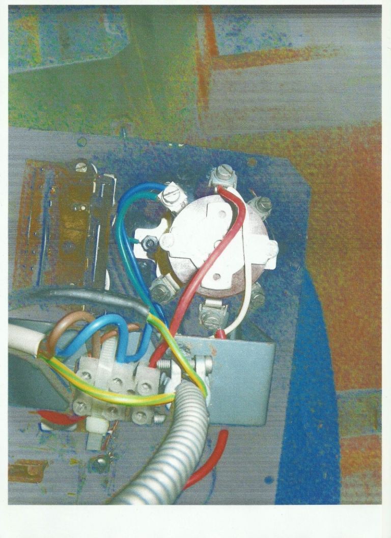

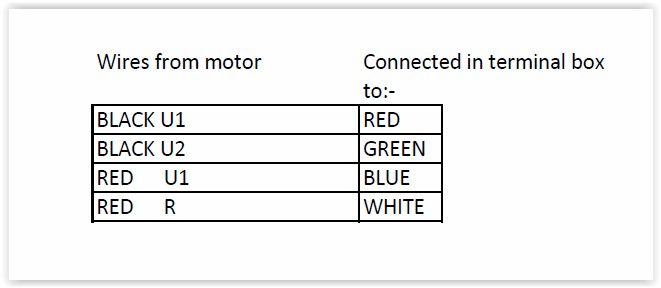

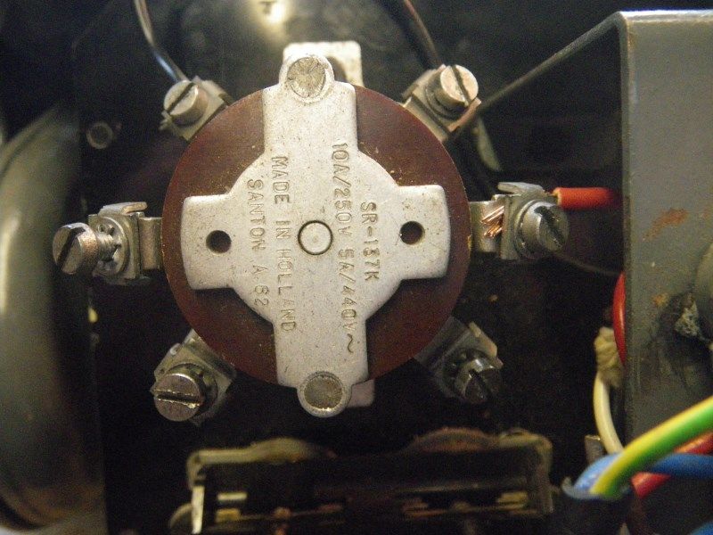

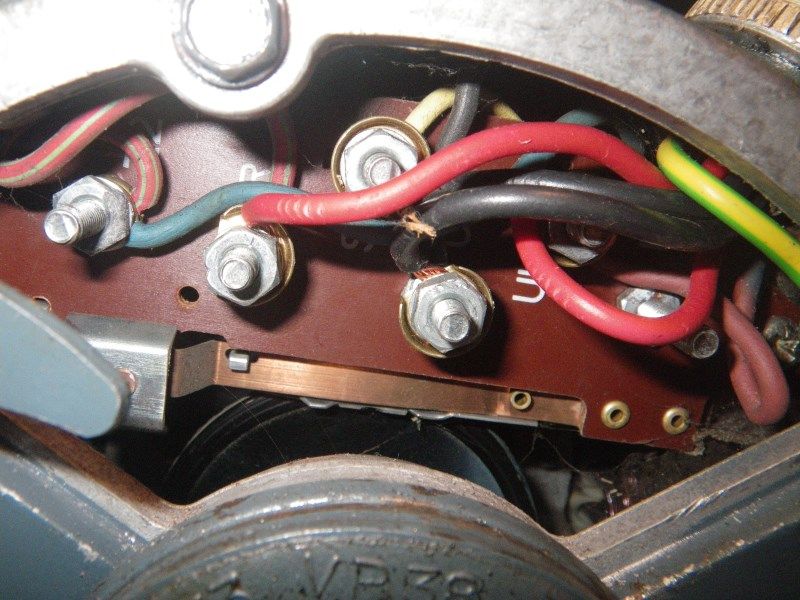

Hi Guys
I have a similar problem.
I can't get the Stanton switch to switch forward/reverse from the Brooke Crompton motor.
On my Super 7
The switch has different connections to that shown in the manual.

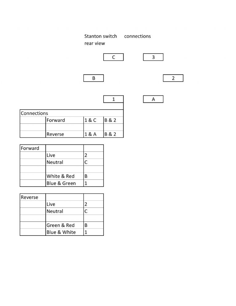

LH from the top, rear view
C B 1
RH
3 2 A
I have drawings on PDF but can't attach them.
Without them the above wont mean a lot.
How do I attach them?
Thanks
Ian

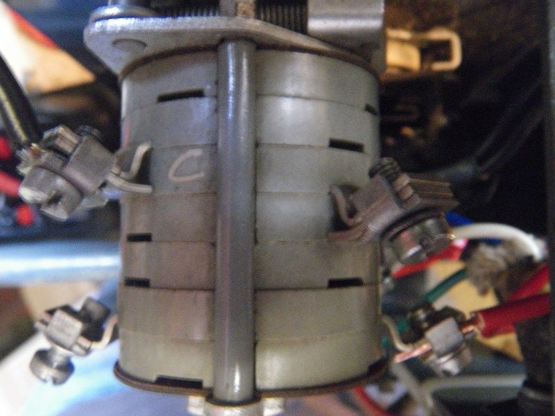

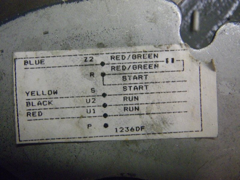

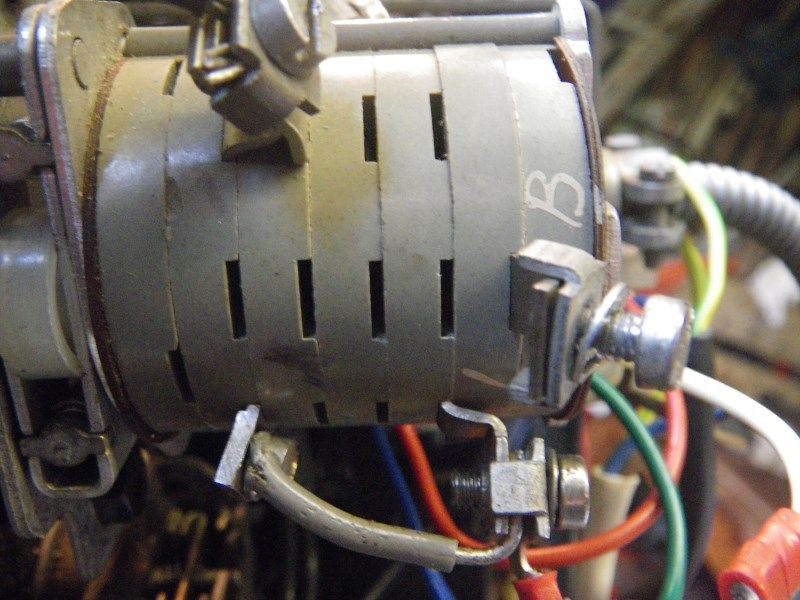

terminal box.jpgterminal box connections.jpgswitch top.jpgswitch photo.jpgswitch link.jpgswitch end.jpgswitch connections.jpgmotor wiring.jpgmotor layout.jpgmotor end plate.jpg
Ian Symes23/09/2014 12:15:21
17 forum posts
21 photos
Hi Les.
As you can see the photos are on the forum,
thanks to a friend who came into the office.
Ian.
Les Jones 123/09/2014 13:24:51
2292 forum posts
159 photos
Hi Ian,
Can you confirm if the switch is 2 positions (Forward Reverse) or 3 positions (Forward off reverse) ? Also can you confirm that the table labelled "connections" in the picture of switch information shows the contacts that connect together in the 2 or 3 positions of the switch and in no position terminal 3 connects to any of the other terminals ? If this is the case then this switch cannot reverse the motor. Is this data from a document or have you worked it out by testing for continuity between the terminals ?
Les.
Ian Symes23/09/2014 14:03:43
17 forum posts
21 photos
Hi Les,
The switch is 3 position.
It is probably the original switch the lathe is on a Myford industrial stand.
The switch position is something I worked out.
I'll check position 3 tonight.
Ian
Ian Symes23/09/2014 21:51:11
17 forum posts
21 photos
Hi Les,
Thanks for all your help.
3 is connected to C when the switch is in reverse.
Ian.
