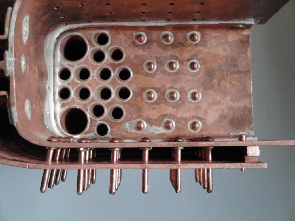

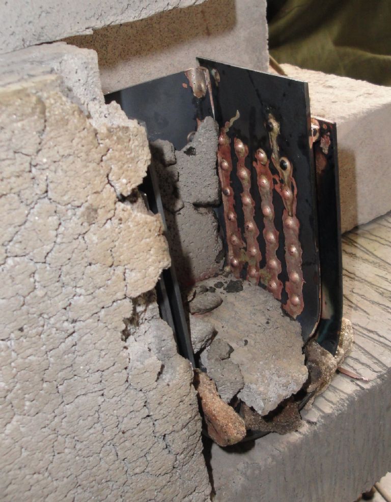

ive added a new album showing how i do firebox stays with propane illustrating my current project namely a 5"g version of Brighton terrier Stepney.
this method hasnt been covered very well in ME so might encourage others to 'have a go'. 15 mins heat up and silver soldering this afternoon start to finish, though making and fitting the silver soldered rings and fluxing up took much longer! the inner firebox doorplate has to be left off to do it with propane.

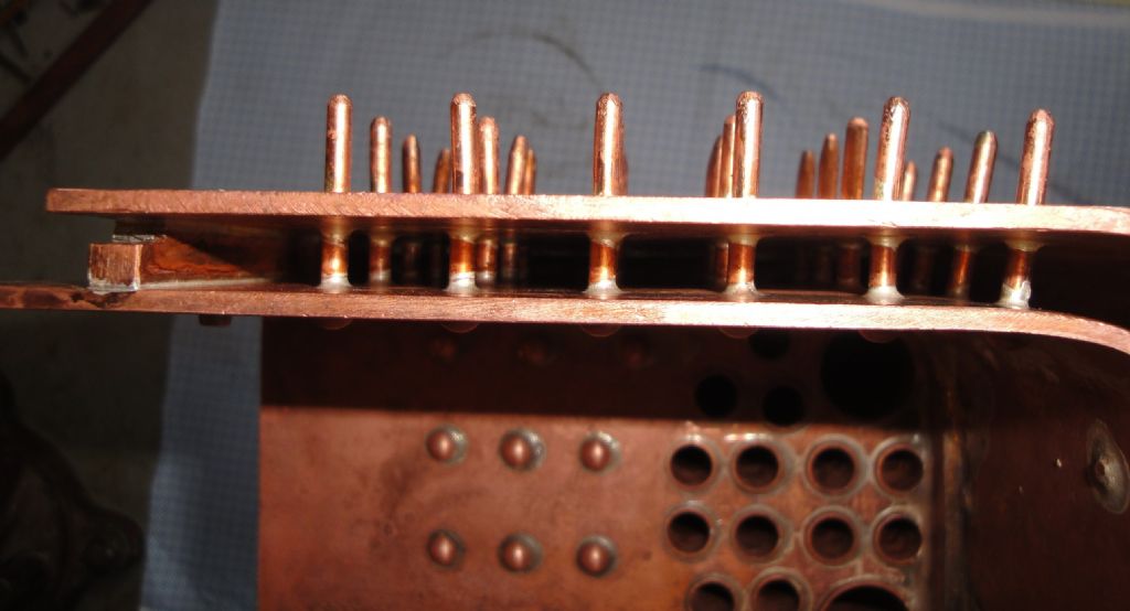

this pic shows how silver soldered rings are fitted hard up against the inner wrapper in the water space as quite difficult to add silver solder inside with the propane torch roaring away inside. then a second pic showing how the silver solder flashes round the stay heads (1/8" dia copper snaphead rivets).

the rings are wound round 3mm rod by hand. the silver solder rod is silverflo 55 1.5mm rod. i dont anneal it first. i know this is what cupalloys suggest ie annealing it but dont want to affect the composition of the rods by annealing it. it works out ok for 1/8" dia copper snaphead rivets as stays. i do it by hand in the vice with a 3mm drill clamped to the rod. cut off the rings with some pincer pliers.
you can usually see the silver solder flash round the rivet heads quite easily when heated up from the inside.

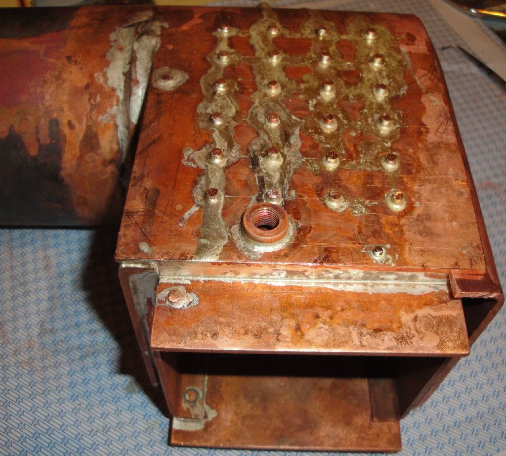

the outside of the stays are done using a long length of silver solder rod run along each row of stays.

Julian, did you solder the inner firebox stays shown above in the orientation shown, i.e., requiring the solder rings to flow up hill to arrive under the rivet heads? I know solder will flow up hill in a capillary gap, but I would have thought that the rings might first soften and lose their spring grip on the stay and slump down before fully melting.

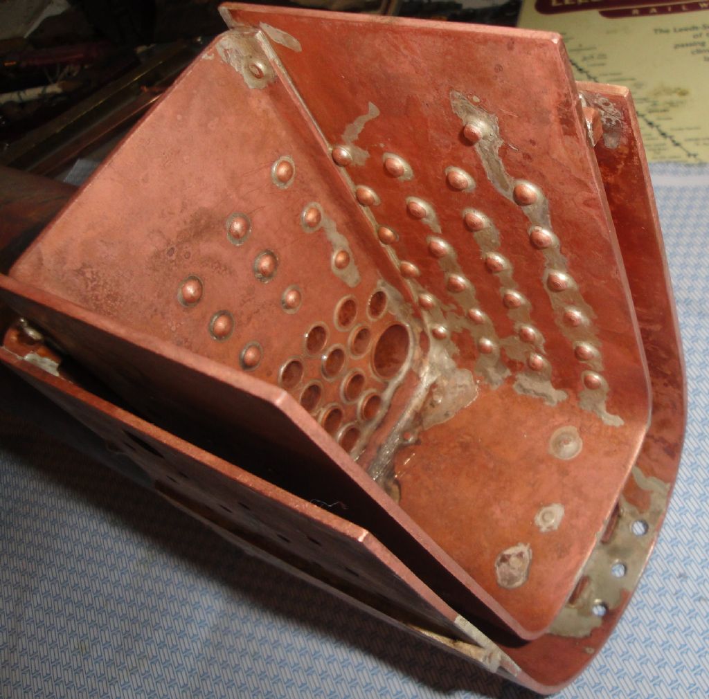

if you have a look at my album on same the set up is shown when being silver soldered ie boiler with firebox pointing upwards, so the stays are horizontal when being silver soldered. also shows the arrangement of thermalite blocks.
you can also see in the album that ive now done the R-H side as well plus that side of the foundation ring.

Thanks Julian, that makes more sense, and hence the runs down the rows of stays. Great pictures.
