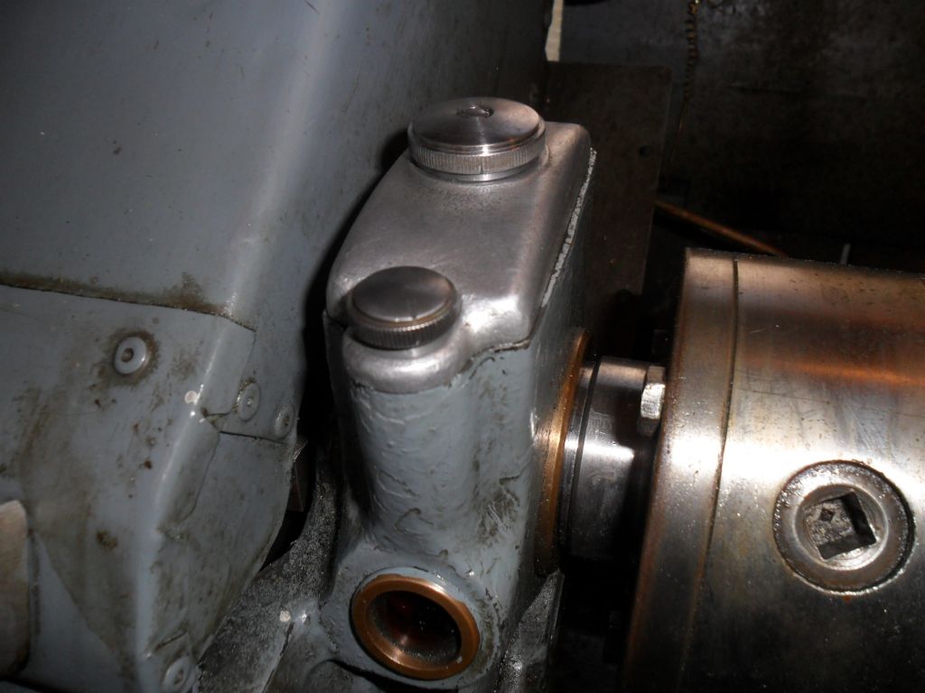

hello,this is my first post on the forum and was hoping some kind person will give me some advice.
i own a very early myford super 7 no sk1453 and it has the headstock oil cup with sight glass.
the problem is the amount of oil flowing through the cup, as i am constantly filling it up when the lathe is running.i do know it is a drip feed but the amount of oil coming from the lathe to the drip tray is excessive and i am wondering if there is a problem. any advice is much appreciated.

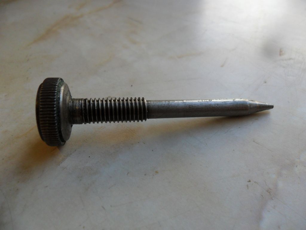

There should be a screw pin above the glass window that controls the drip feed from the oil reservoir. As you say, if it is constantly feeding the bearing with oil it will come out the holes for the gear speed select (did on mine anyway). Is the knob for the screw pin there? Is it fully tight?

Hi John & Guys These photo's may help . one with adjusting screw in place and photo of the screw
Nobby adjusting screw

As Thomas says after using lathe after setting drip feed for use . To stop it keep dripping make sure its turned of tight . If that fails it my need reseating. look under the head of the screw it may be muck or bottoming
