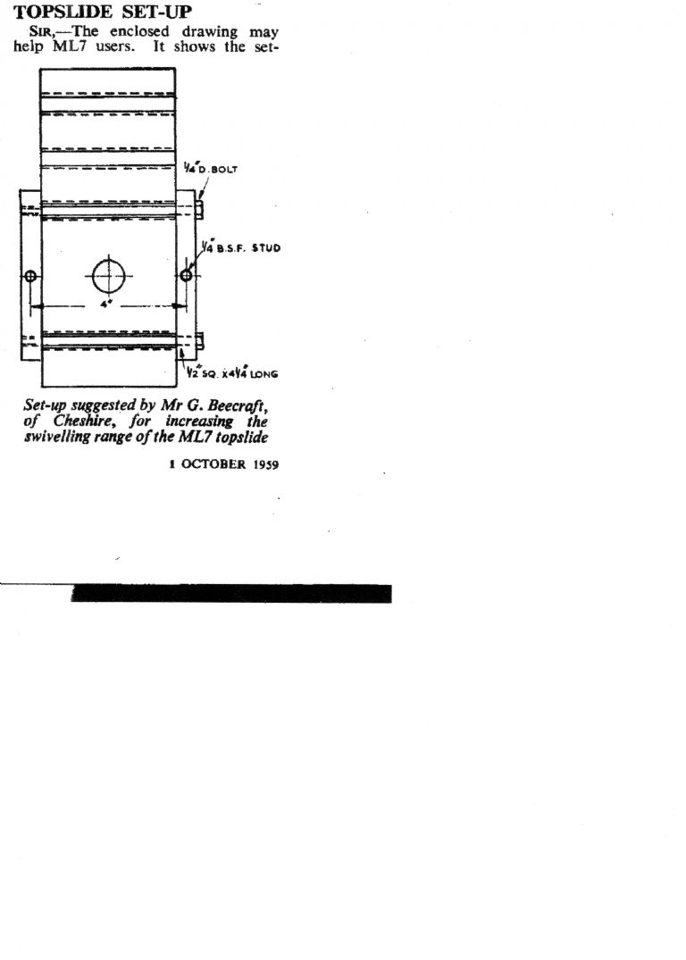

Bubble08/12/2013 21:41:04
75 forum posts
6 photos
Hello Michael
This solution was described by a Mr Beecroft in ME in about 1955
It works fine for screwcutting but watch-out for excessive tool overhang on the top slide which can give an upward force on the assembly.
A refinement would be two long tee-nuts in the cross slide slots, with the two side- bars attached to them with studs, this would provide vertical location.
Jim

Robbo09/12/2013 10:36:26
1504 forum posts
142 photos
Further to Bubble's post, this is Mr Beecraft's original drawing. Just for fun.
anthony smith 409/12/2013 15:08:20
10 forum posts
RE MR BEECROFTS DRAWING THIS DOES NOT APPEAR TO PREVENT THE TOP SLIDE FEED DIAL FOWLING THE CROSS SLIDE DIAL.THE SUB BASE OF 3/8 THICKNESS WILL PREVENT THIS .THE PLATE SHOULD BE 4.75" SQUARE AND NOT 4.5" AS I SUGGESTED

Bubble09/12/2013 18:11:06
75 forum posts
6 photos
Anthony
True, I can "only" go to 80 degrees. I did say it was fine for screwcutting.
In 50+ years with an ML7 I have never needed to go "squarer", that's what the cross slide is for!
I think the loss of 3/8" height is a bigger limitation, especially with quick-change toolposts.
