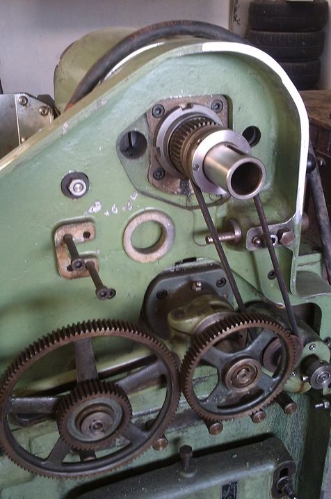

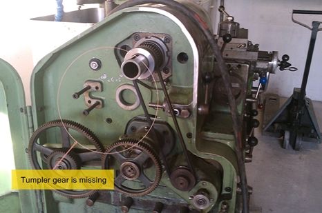

Hi guys,
I also have Boley 5LZ, which I bought recently and I am restoring it now. Could someone of you help me please to get the main dimensions of the tumpler gear, which is misssing on my lathe? I intend to manufacture a replacement of it. Also a photo could be also helpful.
Thank you,
Roman

RK 201430/01/2014 15:38:33
6 forum posts
22 photos
Hi Phil,
my idea is to make a functional replacement if the original tumpler gear, not identical copy as for it it is a casting necessary. It should be a case consisted of be two side steel panels holding the bearings of the plugs of the gearwheels. I can perform milling, turning, welding but not casting.
Could you make a photo of the tumpler gear of your Boley and send it to me via e-mail ([email protected]), please?

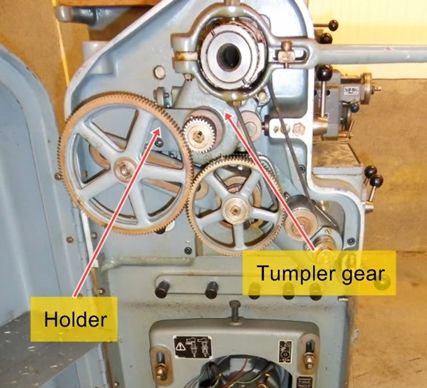

Philip Burman31/01/2014 00:44:09
16 forum posts
Hi Roman, I'll have a go on Saturday.
Phil
Philip Burman31/01/2014 10:12:03
16 forum posts
Hi Roman, Email sent. It's 21mb. If it's too large I will send it as several mails if you let me know you maximum file size.
Phil
RK 201431/01/2014 11:21:12
6 forum posts
22 photos
Hi Phil, hi Mike,
thank you both for your help and for the photos of the missing tumbler gear! I believe it will be possible to fabricate a replacement.
Roman
Robert Söderström17/11/2018 17:54:16
6 forum posts
Hi all,
I also found a 5LZ with missing tumbler gears today, would someone be able to send me the images as well?
Roman, did you manage to construct a new tumbler? Any pictures or plans of that?

RK 201405/12/2018 14:10:18
6 forum posts
22 photos
Hi Robert, yes, I have few pictures of the missing tumbler gears which I have machined. Describe more your situation and needs, maybe I could help you. It is still in progress, once I will complete it I will share more pictures. Now two examples at least.img_20181124_211028.jpgTumbler gear
Robert Söderström05/12/2018 14:47:57
6 forum posts
Wow, have got a new housing cast by a foundry? I am completely missing the tumbler arrangement (and gear bracket)on my lathe,collected it on friday, and although I searched high and low and found a lot of small pieces I could not find those parts I am very interested in any plans or info regarding the construction of it, I am guessing it consists of three gears? Gear connected to output shaft on center of rotation? Gears are the same module as change gears I assume?
Looking for all info I can get on the part. Probably not going to cast a new housing, rather build it up in simpler manner with flat stock and standoffs etc.
