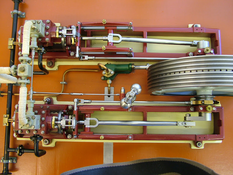

David, Following your posting elsewhere on piston rings I thought you were looking to improve on CI rings hence my recommendation there for PTFE packing
I ran a Twin Victoria for many years both on steam and air as any who have attended the Forncett ME day will testify. That engine, made to Stuarts drawings but using basic castings - ie not from a kit - was fitted with bronze pistons which in turn were fitted with PTFE packing as described on your other thread.
Despite my best intentions over the years the engine was never fitted with a lubricator so I used to inject neat steam oil into where the lube injector was intended - a block set central to the steam inlet pipes. This would gradually work it's way through and deposit itself in the tobacco tin tray laid beneath the exhaust - something else that never ever got improved either. After the initial euphoria of running at events declined it only ran once a year at the Forncett do after which it would be cleaned down, injected with more steam oil and run for 10 mins on the bench and then left until the following year. I can honestly say that no rusting ever occured.
Just found this pic - the oil was injected using a syringe into the small square block
on the left of the pic. This pic is one of the few I took just before I sold the engine about three years ago. Apparently the first Forncett do was twenty years ago next year and the engine was built about a year or so before that.
My advice then, as before can only be to ditch the rings and replace with a bronze piston and PTFE packing - and use steam oil - you won't regret it
