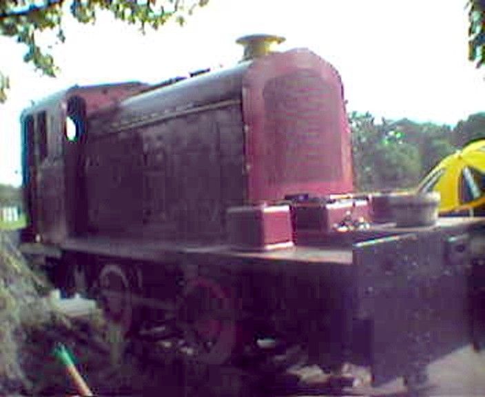

I have some very poor pictures of an old industrial shunter of standard gauge. I think it would be very easy to make it into a 3 1/2" gauge electric diesel outline model, but I have some queries:
It will be rather small, about the size of a Tich, with <2" wheels, on tread. Is it feasible for an electric model of this size to pull a (13 stone) adult?
Is it feasible to use steel wheels? I know full size engines use steel tyres, but is there less adhesion than with cast iron?
What sort of all-up weight should I aim for?
One obvious answer is 'go for 5" gauge', I know, but I have virtually all the materials to hand for a smaller version.

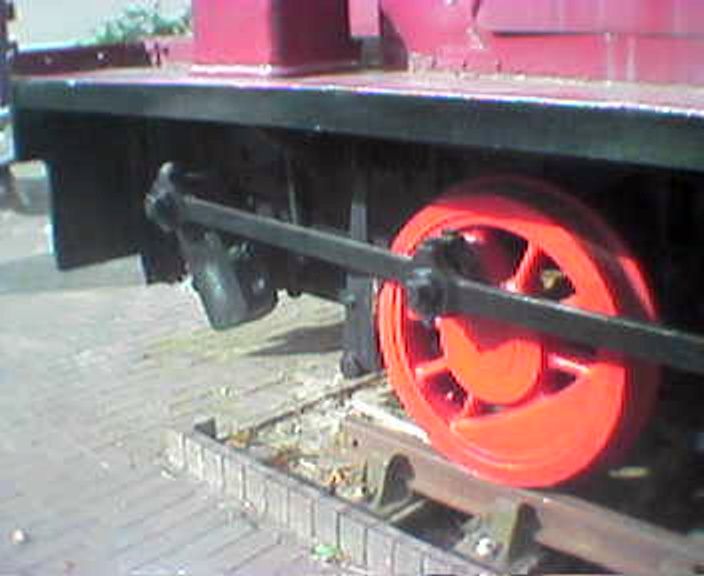

It is quite small, I estimate just under 12" long, so I will have to keep the batteries in a driving car and I doubt it will reach 18kg, even with some added ballast. Here's a couple of pictures, from one of those keyring digital cameras from the days before our phones wer better than our slrs:
Yes, it DOES have a brass chimney! It's outside a pub near Ufton in Warwickshire. IIRC they have something like a gauge 1 railway going around the opicture rail too. I think it may be called 'The Railway' the other pub nearby has an Iguanadon on its sign, the Jurrasic or something like that. It's years since I lived/worked near there.
I might start chewing the frames out of 3mm steel today

Blessed be the Googlers for they shall discover much data!
It's a Hudswell Clarke shunter of 1936, number D604. They built the first diesel hydraulic engine in just 1932, and it was steam outline for a minature railway in the northeast!
Sadly(?) it appears that a private collector from Ely bought it several years ago and its location is now unknown. I found a couple of much better pictures on a shunter website (though they have many copyright warnings ) I also found a couple of other similar engines which help a bit too. There is an engine called 'mighty atom' from Harwell nuclear power station that is almost a twin of this engine, but has added bits.
I now have plenty of detail of things like the missing buffers and couplers. The one thing no photo shows is the springing arrangement or any detail of the hornblocks. It's clear they must have poked down below the bottom line of the frame, but I will have to guess the rest. I'm using a set of Tich hornblocks, as they are for 2" diameter wheels and I think that I will probably use a spring set in the top of each axlebox acting against the inner top of the hornblock.
Can anyone advise how much travel I should aim for? Is about 1/8" under load enough, or sd I go for 1/4"?

Can I re-ask the question in that last post? the engine is presently about 24lbs, with 10lbs on the front axle and 14 on the back - I may be able to add another pound over the front axle, if I can find some more lead.
I have provisionally set the springs (cut bits off) so that there is only 1/16" between axlebox and hornkeep. This leaves bottom of the 'girder' below the buffer beams 5/32" above the rails. Does this sound about OK?
