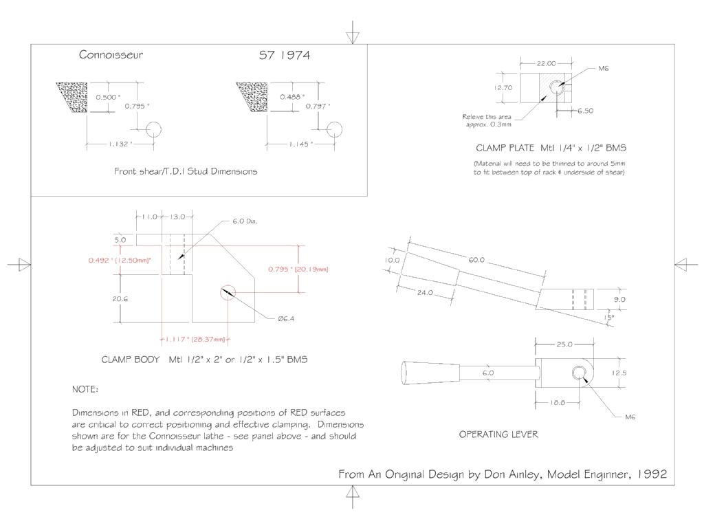

I've lived with this for nearly 20 years (I didn't make it, it came fitted to the lathe) and have found it to be very effective and very convenient - a nice solution to a tricky problem, and I can recomend it without hesitation. Here's the original design by Don Ainley, from ME:
I'm currently making one for my Connoisseur, alongside a friend making one for his PCF S7B - unfortunately we've found that the few dimensions given aren't quite right for a PCF machine, the position of the indicator stud seems to have been shifted slightly on green and blue machines compared to grey ones. I should have the right dimensions before too long, but this is a relatively slow process as it's being used as a teaching exercise for my friend, who's new to model engineering, and progress only happens one afternoon a week. And for some reason has completely stopped over the last couple of weeks!

Thanks Cabeng for the drawing of the Don Ainley lock. To my eyes, that's more elegant than the version I referred to in MEW163. I'll go with your recommendation and will move it up my to-do list!

I see that I made an invalid assumption that it was the Ainley design to which you were referring - Wrong again! So my apologies for disagreeing with you Andrew!
Cabeng21/06/2015 01:08:40
86 forum posts
59 photos

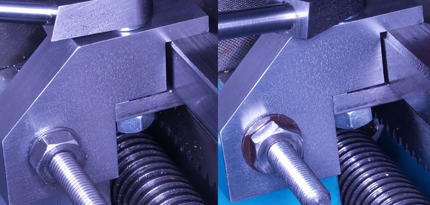

Some time ago (see above) I posted re. a saddle clamp designed in 1992 by Don Ainley, and said that I would provide drawings when I’d finished manufacturing one for my lathe. Colin Rawson has reminded me that I’ve forgotten about this promise (thank you Colin!), so I’ve now put the drawing in an album, along with a copy of Don Ainsley’s original M.E. submission and a couple of photographs. Here’s the drawing:
A mixture of imperial & metric units - I normally work in metric, but the measurements of the mounting stud position were taken using imperial measuring equipment! Anyone intending to make one of these clamps should note the note about dimensions and surfaces shown in red, and the panel top left of the drawing showing relevant measurements taken from my S7 & Connoisseur machines – it would appear that all Myfords are not created equal, and these dimensions do affect the performance of the clamp. It has been tried on grey, green & blue machines and works on all of them, but clamping is noticeably better on the blue one, for which it was made. The effect of variations in the Myford dimensions can be seen here:

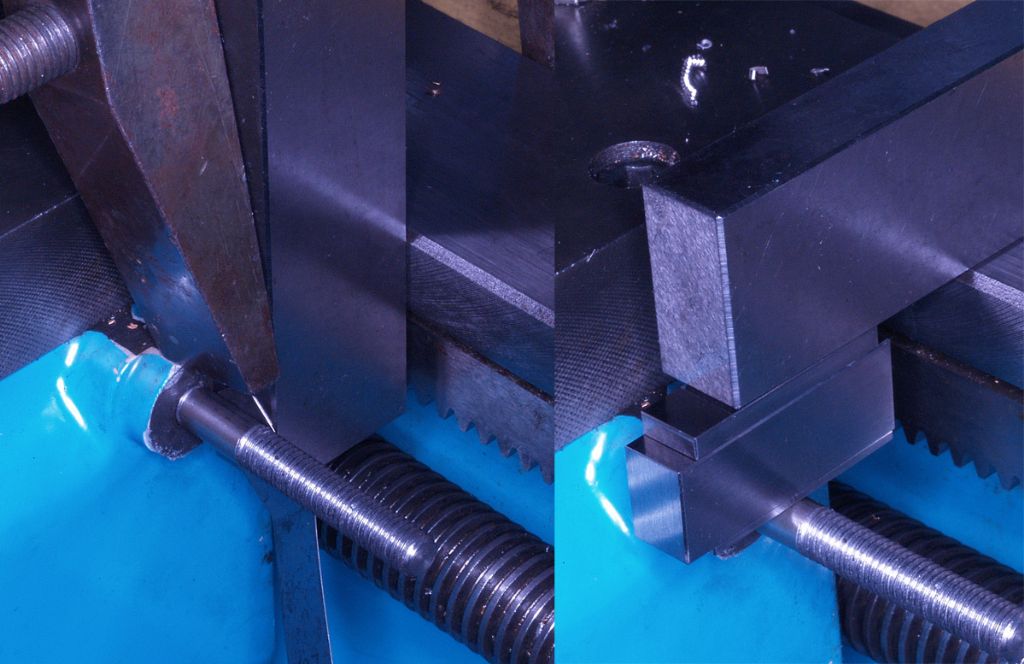

The gap between the clamp and the front of the shear is greater on the grey one, the top lip isn't perfectly flat on the bed, and the clamp plate is more horizontal – so as the note on the drawing says, you should adjust the red dimensions to suit your machine.
To find the position of the mounting stud relative to the front of the bed a 1” parallel was clamped to the bed, distances between the parallel and the stud were then determined using slip gauges for the vertical position and a feeler gauges for the horizontal distance:
Apart from the 'red' items, none of the other dimensions are critical, so I haven't shown them, those that are shown are for information, and do not need to be slavishly followed!
