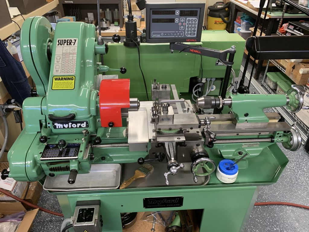

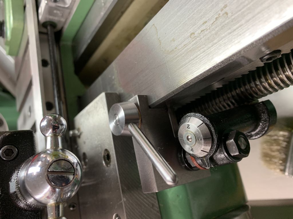

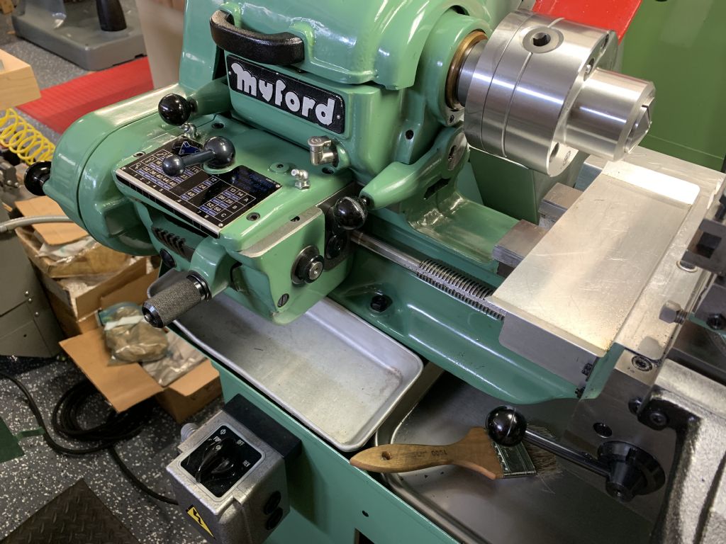

While trying to navigate this forum and figuring out how to post in order to ask a question today, I realized that I owe Barry Harrison aka ‘KWIL’, I believe, a long overdue thank you for his article in MEW December 2002/ January 2003 and his posts here on installing a Newall DRO on a Myford S7 lathe.
What was unique about his installation concept is the ability to retain full use of the rear bed mounted taper attachment. I have actually completed this on two different S7 lathes I have owned over the years. Long story, sold the first one due to a cross country move. Big mistake. Just made more work in the end. Recently completed the second one. Here are some photos. Happy to answer any questions.
Edit: Thanks Barry Harrison for the concept in his MEW article and thanks to Ken Wilson (KWIL) for the photos in his album of a very similar installation and for answering my questions during my first installation, especially for pointing me to the article on the front mounted ‘MYFORD SADDLE LOCK’ by Don Ainley. Not sure what issue, but think it was in ME. Thanks Chris Tice for setting me straight.bdc1e243-2420-47ba-8f75-aa37ec026117.jpeg
Myford S7 Serial #SK164898 (1994?)
Rear view of the encoder mounting and installed taper attachment.
Back of lathe view showing chip guards, DRO cable protection and display/light mounting.
Required extensions for taper attachment. Z axis scale and taper attachment are mounted to a steel plate which is attached via the original T/A mounting tapped holes. T/A is installed lower than original mounting necessitating the distance be made up with new extensions.
Installation requires moving the carriage lock to the front of the lathe. Sorry for the rotated photos. Can’t seem to fix this.
Edited By Michael O'Connor on 08/02/2019 23:59:55

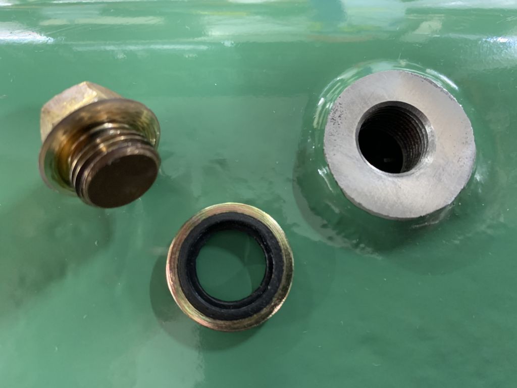

Hello Mark,
I had a similar problem with the QCGB of my Myford S7. The sealing washers on the QCGB drain plug and the cover for the lower mounting screw on my lathe were neoprene. I noticed the part number and description in the Myford manual called out Dowty washers. After finding out what they were and sourcing them from the UK (I am in the USA) I replaced them. However, it still leaked. I put a pan under the gear box and was fairly confident the leak was coming from there because I had to constantly top it off. Kind of hard to isolate an oil leak on the Myford because of the total loss oil system. Also was second guessing myself on wether I installed the o-rings properly between the QCGB and the bed on assembly when I originally moved the lathe.
​​This is the pan I used.
When the Dowty washers arrived, I drained the QCGB and by chance looked at the sealing surface of the drain plug with a mirror and flashlight. Found a low spot that appeared to be galling from the spot facing when it was machined.
I removed the QCGB, cleaned it with mineral spirits to remove all traces of oil, especially in the threads for the drain plug. Packed the threads with cotton balls and carefully draw filed the spotface flat. Carefully removed the packing in the threads and cleaned everything again.
Reassembled everything again with new Dowty washers. After several months of monitoring, am pleased to report that the QCGB is no longer leaking.
Hope this may help someone else who is frustrated by their Myford QCGB leaking.

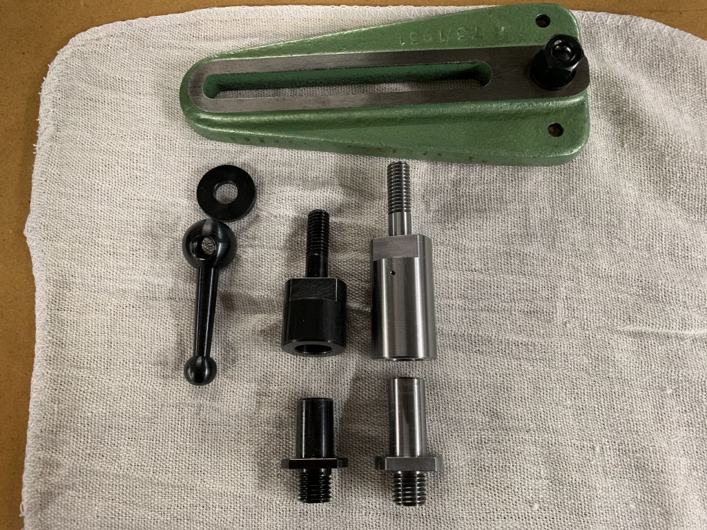

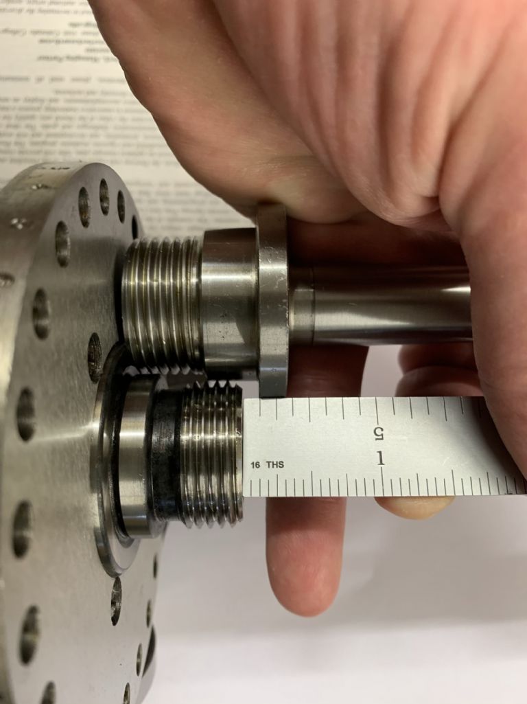

Hello,
I just purchased a Vertex BS-0 Dividing Head with the 1-1/8”-12 BSW Myford spindle nose from Rotagrip. Wanted the capability to transfer the chucks and other spindle tooling from my Myford S7 to a dividing head directly. Because I live in the USA and returning this would be very expensive, I emailed and spoke with Rotagrip directly to make sure this model would have a Myford spindle nose. They assured me it does indeed.
Upon inspection, it does have the correct thread and a spot on 1.250” register diameter. Spindle is heat treated and the threads and register are ground. Threads need to be deburred at both ends, but everything is in order. Except the distance from the end of the spindle to the register shoulder. The Myford lathe spindle is a nominal 1” length and the dividing head is 0.865” or approximately 1/8” shorter.
The problem with the missing 1/8” of thread is that the Myford Burnerd chucks, faceplates, etc. only engage 2-1/4 turns. With a thread lead of 0.083”, that is only 3/16” of thread engagement. With a hardened D/H spindle thread and cast iron chuck backplates, that could be a potential problem with cracking or failure of the cast iron internal threads.
My questions to other BS-0 D/H owners: Are your D/H spindles 7/8” long and has this ever been an issue for you?
Another odd thing with this unit is that it came with a lathe dog, I am guessing, instead of a proper dog driver. See photos below. The 2MT center has the short parallel diameter to attach the dog driver. Not a big deal to make one, just curious that it wasn’t included. The blank chuck backplate has a 1.250” register diameter that is too short to be mounted on the Myford lathe spindle but it doesn’t have a slot to drive the supplied lathe dog. Any work dog would need to be held captive on a D/H, so that probably isn’t what was intended. Have other owners received a proper dog driver?
Ian at Rotagrip told me this model of BS-0 (Model T) has been discontinued and he believes this was the last one he had in stock. I wanted to ask of others experiences with this model before contacting Rotagrip.
