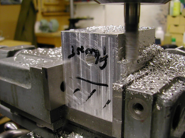

I'm in the middle of making a boring head for my milling machine. I have cut the female half of the dovetail which turned out very well after an initial cutter jam. After the jam I increased the cutter speed and nipped up the cross slide gib strip to reduce any back lash. I took cuts of about .5mm which seemed to be the maximum the machine could handle ( Tom Senior Light Vertical). During the cutting the cutter appeared to make dust rather than normal milling cuttings. Is there anything I'm missing prior to cutting the male half of the dovetail. Many thanks for any advice given

Hi Peter, I wouldn't worry too much about the swarf as usually the cutters are multifluted and tend to create that situation. You don't state the material but I'm assuming steel.
I would however be more concerned by the fact that you need to tighten the gibstrip to 'eliminate the back lash'. That to me sounds like you were possibly 'upcutting' ie the edge being cut was moving with the cutter rotation. That would certainly explain any grabbing of the cutter and potential jamming. I would however 'finish' the final cut by upcutting as normally this produces a better finish but the cut should only be taking a whisker off
The .5 depth of cut may not seem great but the length of it is so may be back off a little on depth. DT cutters are cutting over their length at varying cutting speeds and don't act quite like a normal cutter. It may help to take out the major area for removal in steps before finishing with the full face length. It won't hurt either to slow things down a bit on speed and feed from what you would expect from a conventional mill of similar size.

It goes for all usual helical cutters not just dovetails. This pic from the Racer file shows a rippa cutter climb milling on the crankcase. 10mm cutter radial cut about 2mm depth about 12 I would say. Another slight advantage on ally is that the cutter has less tendency to load up particularly when you have no coolant system to call on
I must stress again I am not advocating this as the way to go - it is very easy to 'catch a crab' very quickly indeed even if you are ready for it so tread carefully.
