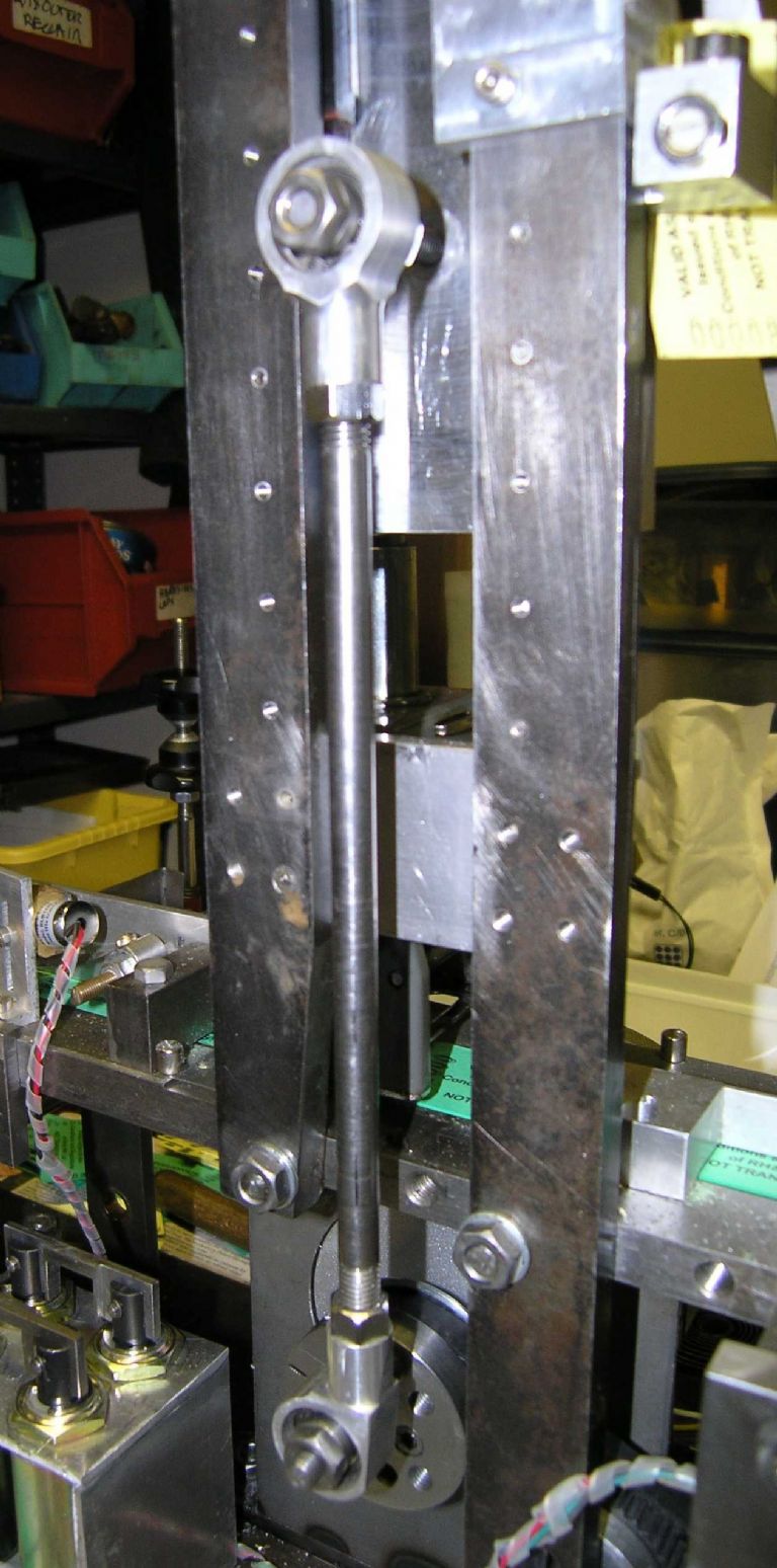

Peter Bell06/12/2010 18:51:09
399 forum posts
167 photos
Hi Neil,
Thanks for the advice, here is the rod in question.
It is driven from the crank at the bottom and pushes a numbering head up and down  mounted on linear bearings on the other side.
It is difficult to disengage the crank as there is also a pully mounted with it which drives other parts.
Odd I know but I thought there is bound to be someone out there who has done this before?
Peter

Peter Bell07/12/2010 23:03:26
399 forum posts
167 photos
Good idea Neil.
Not sure if the drive motor(stepper) is powerful enough to do this with the head clamped as it takes around 4kg to pull the head down--food for though--I'll see what springs I have.
The machine is for numbering Edmondson railway tickets, built by someone else who made a great job of it, I have just been modernising it a bit
Peter

Peter Bell10/12/2010 07:48:59
399 forum posts
167 photos
The problem is that both the numbering head and ticket feed are driven  from the same motor and if a ticket fails to feed the ticket under the head gets  stamped again so the numbering sequence is wrong. I have electronics monitoring the ticket feed output which stops everything if it does not see a ticket out which has vastly improved things.
Ideally it should have two motors but the operations need to be "in time" and It is  difficult to synchronize them. I have tried operating the numbering head with solenoids as a lot of commercial machines do. This was fairly succesful but the numbering head became unreliable at the speed it worked at and generated errors.
Sorry to bore, I just thought someone may have a neat solution ie a clutch in the rod, dont want to spend the rest of my life rebuilding the machine!
Peter
Peter Bell17/12/2010 13:42:25
399 forum posts
167 photos
Hi,
Just an update on my rod link/clutch. Made a rod and sleeve with a pawl. The two are locked together until tripped by another  solenoid operdated rod which disengages the drive. I have some electronics to sense when and it it needs to do this.
To my surprise it seems to work fine!
