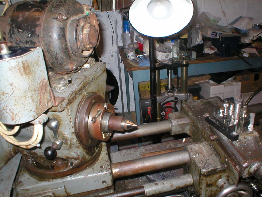

John Coates09/10/2010 21:21:23
avatar
558 forum posts
28 photos
Update on this
I used the adjustable headstock on my Barker to re-cut the centre and remove the "nipple" at the end. Measured the centre as 60 degrees so set the headstock over 30 degrees (its maximum anyway). Like this:
I then used this method to cut the MT3 taper for the die holder. Set the headstock to approx 1.5 degrees and cut it in no time. Didn't blue it up and test it in the MT3 socket (will do that later) but just swapped the MT3-MT4 adapter, put the new taper in and cut the end down to 12mm as the shaft for the die holder
Quite impressed by the Barker in this respect. It made taper cutting less of a daunting prospect. As with all my newbie work at the moment, its not pretty but its functional and will get me started tapping and cutting straighter threads !
