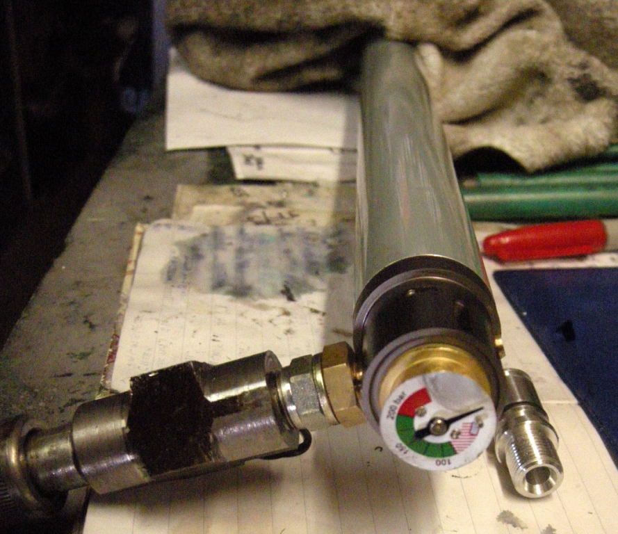

Heres a 200bar cylinder I didn't expect to take 300bar, and the gauges are inaccurate. **LINK**
To even make a pump it will set you back not only in materials £40? but guage £7 to £70, hose £25 and quick fills £20+ and wont be too much short of buying from a shop around £140 tested and made for the purpose. Even then face the constant music of dispersing hot air on to filler valve and burning out. Even seen knock open valves burn due to using pumps because of the short bursts of air creating heat more than from a dive bottle. Forget whats its called but the prototype electric Daystates used tell you the temp within tube.
