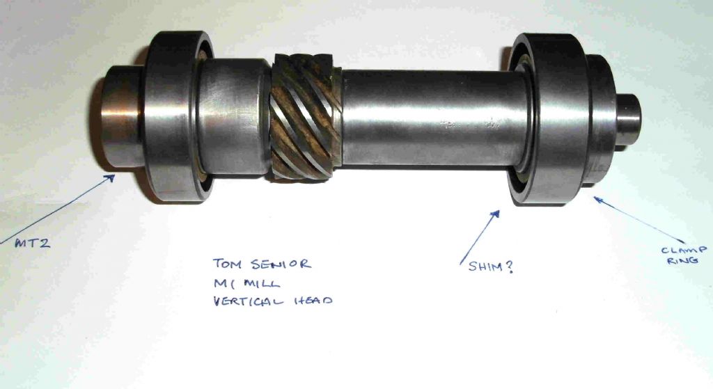

Got an unexpected morning off - and inevitably I spent the rest of the night wondering about the M1 head assembly and how it was supposed to work... it's amazing how much somebody else having a similar problem focusses the mind!
So, I've taken a picture of the shaft as it is at present - assembled, but out of the casting:
The way I think that it's supposed to work is that shims shouldn't be applied to the outside of the bearings at all (which is what you appear to be indicating has happened on yours), but at the point I've indicated on the picture. The idea appears to be that you do a trial fit with the bottom end cap in place, and when you screw down the upper cap, you check for end play. Remove the upper cap, release and unscrew the clamp ring, which releases the bearing. Place appropriate shim on the end of the sleeve so that it's pressing on the bearing inner, replace the bearing, clamp it up again and replace the cap. Then recheck the end float, and probably do the whole thing all over again - possibly several times. Incidentally, the original bearings are Hoffmann thrust bearings, LS10ACD/MS9ACD.
So, just to be clear, it appears that you adjust the preload by forcing the inner part of the upper bearing more firmly against the upper cap, which has the effect of forcing both bearings apart slightly against both caps. I'm still thinking about where the forces end up with this design, and whether I like it or not. It's clear that any axial load is taken by the upper bearing  - I can't see it being any other way. There doesn't appear to be enough room to double up on the lower bearing as I'd hoped - it would foul the larger drive gear.

Circlip16/12/2009 13:58:34
1723 forum posts
Don't ya think that a clamping "Washer" could be fitted between the outer race and the cap??
    Regards  Ian.

Steve Garnett16/12/2009 16:04:00
837 forum posts
27 photos
Posted by Circlip on 16/12/2009 13:58:34:
It certainly could - and it would achieve the same result without having to disassemble the whole thing. My only problem with it is that this is a  2 1/4" OD bearing, with a 7/8" ID for the shaft. And on a decent unworn bearing, you'd need washers only a couple of thou thick - if that. Despite the potentially easier task of changing them, I think that these washers are going to be a lot easier to fabricate in a smaller size - unless of course anybody can provide information about where to get the items ready-made...
But I still don't like it, and I'm pretty sure that Antony doesn't either! So I suspect that both of us are likely to spend some time trying to figure out whether there's a more satisfactory way of achieving a correct adjustment without disassembly.
Antony, I've read everything you said, and I'm having another careful look at the Sandhu "Spindles" book (WP27). One of my concerns with the existing arrangement is where any axial loading is transmitted - into the top of the casting. Somehow this just seems wrong to me in terms of the applied forces, although I'd be quite happy to be talked out of that by a convincing argument...

Steve Garnett17/12/2009 11:03:59
837 forum posts
27 photos
Okay, I think I've worked out the answer to doing it properly, as Antony and I would like. I'll do a proper drawing of it as soon as I'm able, but a brief description I can provide now:
This is based on what Antony has already done - in other words turning the bearings around so that the thrust force on them is reversed, and putting a sleeve between them. The idea is to get at least the top end cap out of the force equation altogether, and achieve an adjustable preload, preferably using what's already there - and it can be done. The first thing is that a close-fitting sleeve has to be fixed firmly to the casting at the appropriate place - not too difficult to achieve at all - it could be loctited and pinned, because it never has to come out again once it's in position. This would enable the axial force to be transmitted into the casting around the centre of the MT sleeve - which is where it should be; as close to the source of the force as possible. All the bottom cap has to do is hold the bearing in approximately the right place for assembly purposes; in the final analysis, it doesn't even need to do that very well either - it's pulled against the sleeve from above.
At the other end, it gets more interesting. At present, the clamp ring just forces all of the components on the shaft together, and doesn't provide bearing preload at all. But, if the long shaft sleeve was locked in place independantly (its only function now is to stop the keyed helical gear from moving up the shaft), and it was made very slightly shorter, then the screwed clamp ring would now be free to move the inner race of the bearing in the thrust direction - thus providing the preload adjustment by pulling both inners towards each other. And that effectively takes the top cover out of the equation completely, meaning that the whole assembly can be adjusted just by removing three hex bolts and slackening one locking screw. As far as I can tell, you'd only have to take 25-30 thou off the sleeve end for this to happen, and you wouldn't run out of thread for the adjuster either - not for quite a distance.
At the moment it's just a thought exercise, but it seems to meet all of the design criteria. Antony, since you have one in front of you, do you have any comments?
