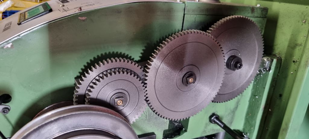

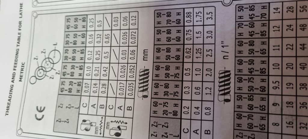

Recently bought a used WM290V. Trying to set the feed and I can’t seem to get a fine feed. Setting up as the finest feed as the diagram it should give 0.0025” per rev. In use it is quite course and I have checked the gear setup twice and I’m confident it’s correct. I can’t see anyway of getting a finer feed, am I missing something.

Post an image of the gear train from the front with the end cover removed and also one of the chart on the lathe, It's probably the same as my 280 but will be easier to check with the chart

One other point, the gear chart with the lathe doesn’t give a lower feed per rev than 0.0025”. Has anyone found a way to slow the feed down.

Hope the photos help. I'm going to run the lathe at 1000rpm and see how long it takes to travel an inch. Just incase it's my perception

Thats a metric chart so assume you have a metric leadscrew. so th efinest fee dyou wil get is 0.07mm/rev (0.0028" )
Although I can't see the 20T gear on the inside the rest looks to be right if C is selected
Easier way to check is put a Dti against the carriage and wind the chuck say 10 revs after taking out teh backlash and see if the carriage moves 0.7mm

Checked this afternoon, and it’s working as it should. Checked with the guy that bought my Chester and he says that is set at around 0.0015” per rev. In the 4 years i owned it I never changed the gears and got use to how it was. Got to get use to faster production.
