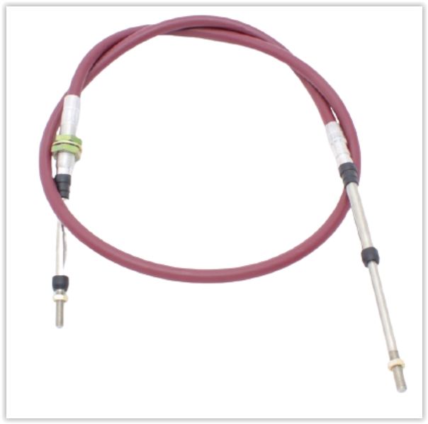

An option is to use Push/Pull cables for the remote controls.
