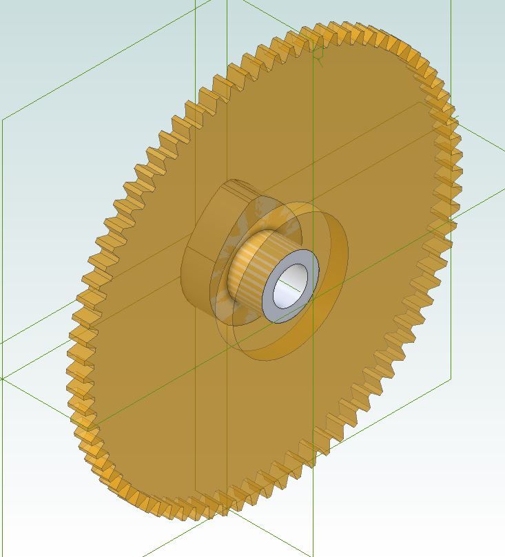

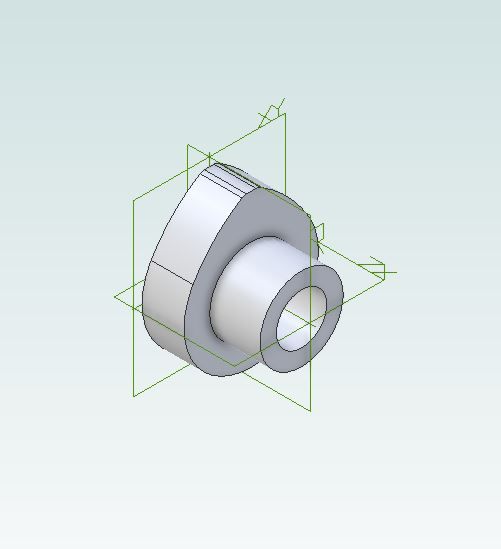

Regarding your cam & gear from Youtube. I think your best be is going to be to make the gear with a spigot to fit closely into the gear's 9.9mm bore. You can then ream the whole length out to run on a 6 or 8mm diameter pin. Loctite should be strong enough to hold the gear to the cam's spigot.
This is the Kerzel gear scaled up to suit the larger 1" bore of the engine from the original 3/4". Not sure what you are going to do with the ignition trip so I have left off the flat for that as I would consider moving it to the other side of the engine.

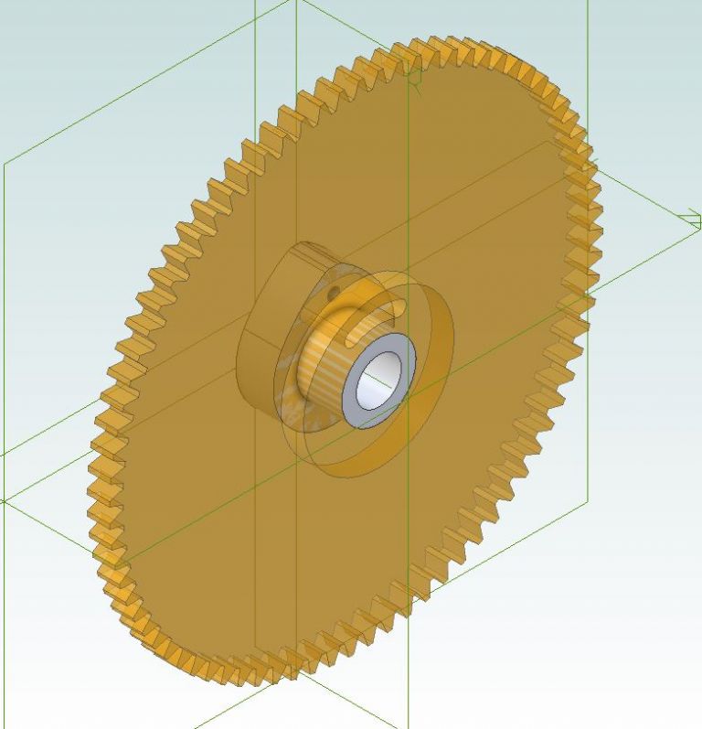

And this is it with the gear in place, I have shown a reduced thickness boss as per the Kerzel drawing though I don't really see any point in it if fitted to the cam as shown particularly if you are tight for room
If you did want micro adjust then a curved slot in the gear and M2 tapped hole in the cam would sort that out

Many thanks Jason for taking the time to do this for me. On later video's i have discussed the cam idea & the arc slot for adjustment.Your idea is a slight variation to what I was going to do. Which was to narrow the gear boss down & sit the cam over it. I guess either way works out the same. I have already turned the 2 gears down in width.
