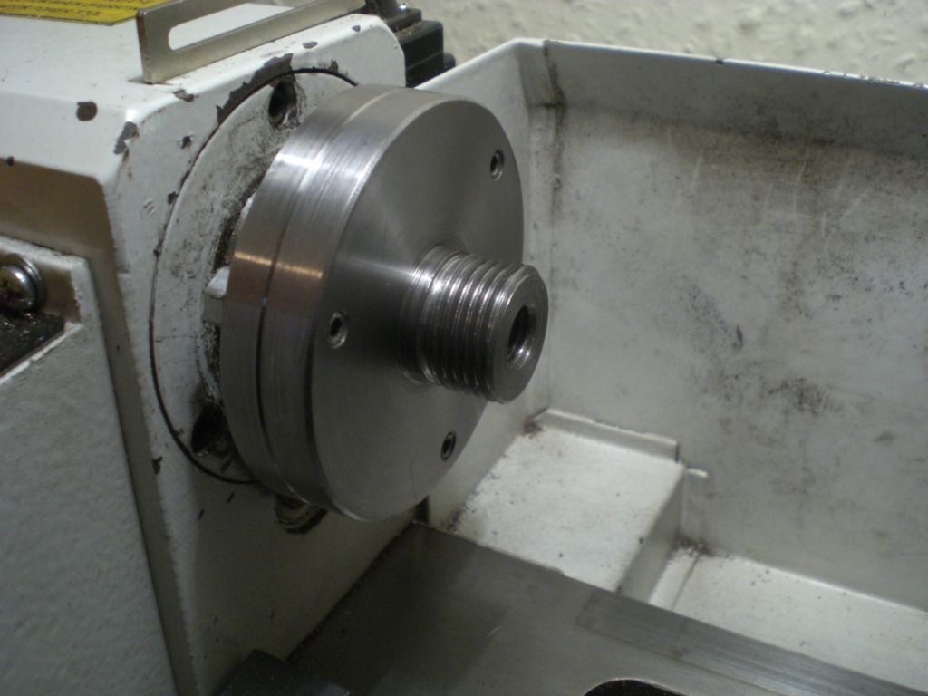

Hi Jack, I've made chuck backplates for my father's old RandA B lathe using a 1" UNF tap, and they fit without any problem. I've also made a chuck backplate to fit my mini lathe, to mount the chucks from his lathe, to use on my mini lathe. When offering up a 1" UNF tap to the spindle thread from a RandA lathe, the thread angle is the same.
Just be sure you don't use a 1" NF, as they are 14 TPI.
Regards Nick.
