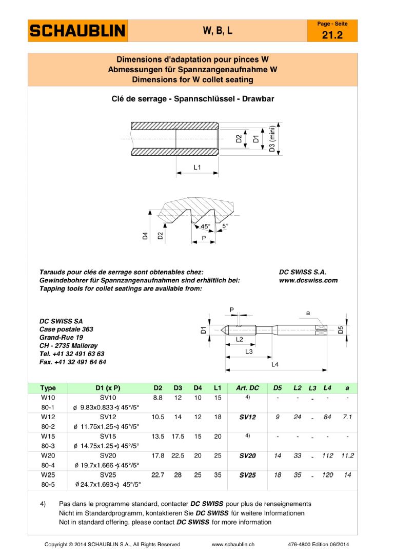

The collet pushes directly in the centre opening. It is clear through to the back and appears to possible be draw in by a suitable drawbar. I would think that this would be easy to make for when the table is orientated vertically but need to look in to whether there is enough room underneath when the table is horizontal. I have just ordered a w20 to M.T.1 conversion sleeve from Luxembourg. with a few to making a Morse taper centering ball piece for when the table is tilted. I will be cleaning and servicing the table so will hopefully get a better understanding of the way it works. It is extremely well made and uses high quality materials. If anyone has a Hauser table manual that is available to copy , I would be grateful if you could please get in touch.
I intend to investigate making a drawbar for the table and will let you know how I get on.

You may find this useful, Keith

Thank you so much for that information. I can use this when grinding the threading cutter. It is interesting that it seems to equate to a 15 TPI thread which I think was a buttress thread as shown by the American Walter company hence the W designation. I will design a short drawbar with maybe a pin wheel type of end diameter to allow for tightening of the collet without too much stick out from the table. I always enjoy the way one thing leads to another in the matching world.
