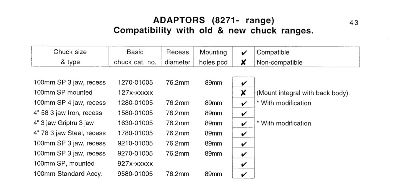

I’ve seen reference online of “The ISO standard Pratt Burnerd 4" system” in reference to Chuck Backplates. Do any of you know what the specifications are for this, register and PCD?

I found this just in case it’s of use to others.

Posted by Vic on 19/09/2022 14:13:08:
dont know Strange that ISO would have standardised 4”

Agreed. PB no longer seem to sell a 4” chuck anymore either. Still, I have what I believe is the information I need so it just remains a curiosity as to where the information came from.

So I searched for your phrase, complete with the quote marks, and landed here:
**LINK**
https://www.beaufortink.co.uk/lathe-spindle-thread-look-up-table
Nice diagram, but a questionable reference.

Posted by Michael Gilligan on 19/09/2022 16:34:35:
**LINK**
Thanks for that Michael. It doesn’t seem to match what I found in the PB reference.
