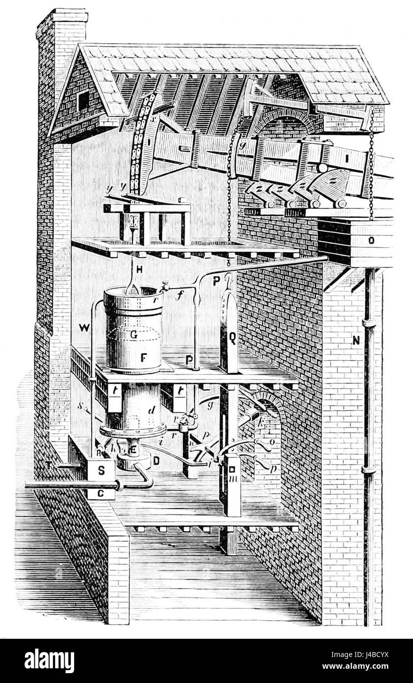

Just wondering about the process for the cool water injection into the cylinder to create the vacuum. Do we know how was this was done on an early 18th-century Newcomen engine, and how it's done on models of today.
I thought perhaps with gravity by housing water higher than cylinder, but I'm not sure if this would work as I'm an absolute beginner to models, engineering, physics, etc.

SillyOldDuffer11/09/2022 15:13:38
10668 forum posts
2415 photos
Depends I think on the date of the engine. This picture is of a Smeaton improved engine, he eventually tripled the efficiency of Newcomen's original by optimising the relationship between piston diameter and length of stroke, the number of strokes per minute, and the size of the boiler.
In this example the boiler isn't immediately below the cylinder, which I think means Smeaton was able to do better than the original pot boiler.
However, the engine:
  • Lifts cold-water into high-level tank O with a chain pump dropped down Pipe N. The pipe goes down a well. The pump chain is driven by a separate beam linked to the main beam (I)
  • Cold water flows from tank O along Pipe P. A proportion of it is diverted to the top of the cylinder by pipe f. Pipe f feeds water to the top of the piston, the amount being set by Tap r. When the piston rises, any surplus water on top is drained into the Hot Tank S. The purpose of this top feed is a little controversial: some say the water just improves the piston seal, which was very poor. Others say the vacuum stroke also pulls cold water in at the cylinder top and significantly increases the power of the engine.
  • The other end of Pipe P feeds cold water into the bottom of the cylinder, via another tap r, which is turned on and off by lever g, is driven by pegs on rod Q. In the original engine, water just flowed from a single orifice into the bottom of the cylinder. In this drawing, dotted lines show pipes set up to spray water into the cylinder from several places. Several sprays condense the steam quicker than a single pipe for more power, better efficiency.
  • After the stroke, hot water is emptied into tank S, and used to top up the boiler.

You can see how James Watt improved efficiency by moving the condensation process out of the cylinder to reduce heat loss within the cylinder.
With such a small pressure difference the piston and cylinder need to be large to produce enough power merely to overcome friction and accomodate the heat lost to the incoming steam caused by the in cylinder condensing.
Friction will be proportional to the cylinder diameter (Circumference ) while area (Force available ) will increase as the square; so bigger is better.

You need to get hold of a copy of 'The Steam Engine of Thomas Newcomen', by Rolt and Allen. Get the Landmark edition of 1997 if possible, it has a better bibliography. This book does mention a wide range of information about this engine.
Gravity was used to give a pressure to the injection water. It was simple and effective. When John Smeaton started to look at the design of the engine around 1770, he said that the injection water system should be as high as possible in the engine house. He also specified that the injection water nozzle should be square. This broke the jet up to provide a better spray. To see how this works, look at the internet site ' physicsgirl smoke rings ', and see the effect of blowing a square smoke ring. Water, being denser than air would be slightly different, it would tend to fly outwards.
Getting water up into the injection tank was an interesting problem. The Thomas Barney 1719 engraving of the Dudley Castle engine shows a small pump connected to the beam by a heavy connecting rod to pressurise the water sufficiently for it to rise to a level where it could flow into the injection cistern. The jack head pump came a little later ; it was connected on the main pump end of the beam by a light chain. As the main pump was lifted, the jack head piston was also lifted, forcing water up a pipe to the cistern. The John Smeaton engine drawing shows a more complicated arrangement using an auxiliary beam to operate a lift pump by a chain connection.
Model Newcomen engines have different problems, you would probably need a small motor driven pump to supply injection water at three or four psig. The main pump on such an engine works best using a jack head pump with an adjustable valve to control the flow of water from the pump. A friend of mine had a model engine, built by a toolmaker from his scrap box. I first saw it about 1998 or 99 at a Heritage weekend at Elsecar. I walked into a room with this model working away in a corner, started talking to the operator, and over twenty years later we are still talking. His engine was driven by steam from a pressure cooker, ran very effectively, and provided information about these engines that can be found nowhere else. This engine has now worn out, he has another that he built based on the Dartmouth engine. The single lever valve gear has caused problems, so is probably unsuitable for a model. He thinks that model Newcomen engines can work very well, but do need care, starting with the fit of the piston in the cylinder.
