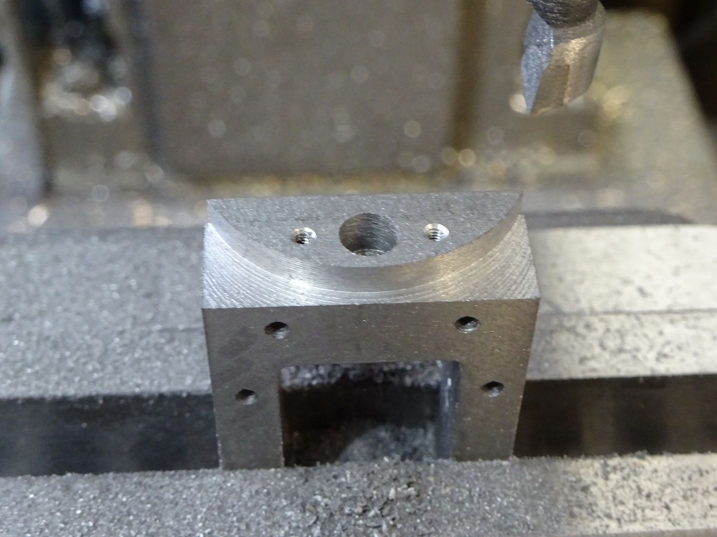

I'd make the block wider than the 60deg arc if that is the width of your timber, being able to roll the block will make sanding more efficient and the abrasive less likely to clog and even if you want to sand straight you are unlikely to be able to hold the block dead in line with the edges of the wood.
With 16 plane to make I'd be looking a knocking something up to rotate the roughed out wooden blocks against moving abrasive, with a movable pivot so you can do different radii.
If you have a lathe I would cut the concave face of the sanding block with that, more likely to give the numbers you want without having to allow for under/over size prints, casting shrinkage, surface finish on print or casting, etc

yes would need a different approach now you say you are making more complex moulding planes. I got rid of 4 large stacking boxes of them about 10yrs ago, gave them to a french polisher that I did the odd bit of turning for. These days if its a shortish run needed I'll just rough out by a series of saw cuts, odd bit with a spindle moulder or router and then just hand finish. Quicker and cheaper than getting a pair of knives and limiters made for my spindle moulder.
As for machining the blocks a simple bar driven by the chuck and supported by the tailstock, drilled for an HSS blank and cross drilled for a locking grub screw will do. Just adjust tool projection to alter radius.
Concave can be done by mounting on a carrier and just turning the outer radius for all but the very smallest
Also hopefully it's obvious but your radius on the convex blocks will need to be SMALLER by the thickness of the abrasive.

On that one the cutter was extended. I have done others with angle plates or a vertical slide where the radius can be set and then the cross slide used to feed the block for each pass.
Depending on length of your block a boring head on the mill works either vertical or horizontal. If you have a collet or collet chuck that will fit your horizontal mill then you can grip a bar and arrange a ctr to support the other end. Set radius and then move the work.
