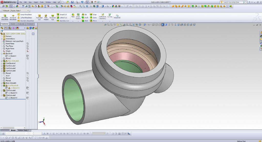

This is my first attempt to model a Lunkenheimer carburetor.
I made this model a few weeks ago.
I think it is almost done, but perhaps not 100%.
Not too bad for a first attempt, in my opinion, and not much time spend on this model (perhaps 2 hours).
I had never modeled a carb before, and so I just stumbled my way through the model.
My approach to modeling is to create a model in any way that I can, no matter how crude or clumsy the appoach or model may be.
If I succeed in creating an accurate model, even if I used very crude methods, then I use the model "as-is".
If I revisit the model later for use on another engine, I may re-model some parts of it, or create a new model entirely, if I think of a better more efficient approach.
The main thing is to create a usable model.
Don't worry about winning a "3D modeling efficiency" award; just get it done and refine your technique later over a period of time.

More screen captures.

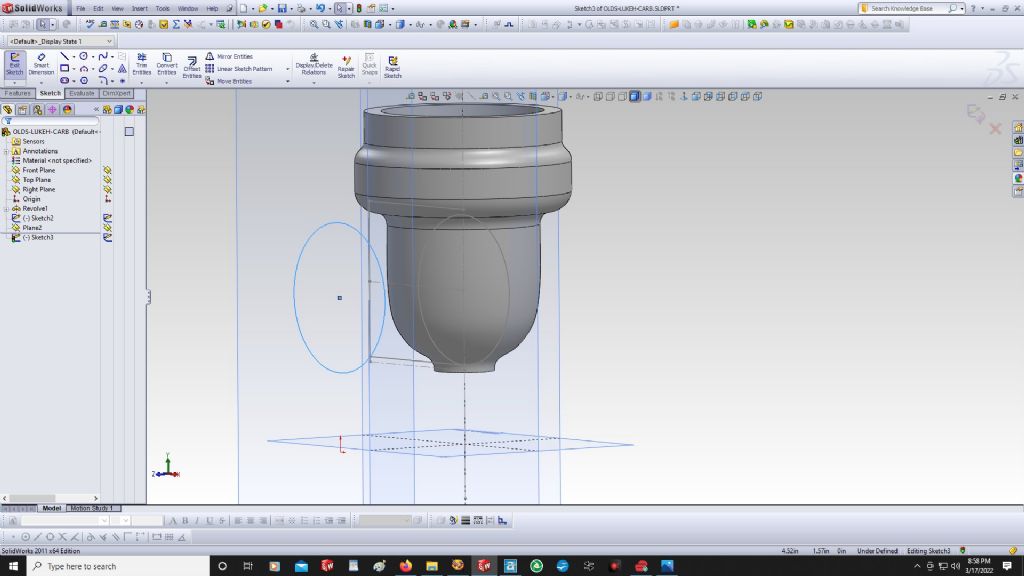

PatJ11/05/2022 03:15:43
avatar
613 forum posts
817 photos

My intent as with all of my 3D models is to 3D print patterns, and then cast the parts.
The original sectional sketch that I used to rotate the initial bowl shape was taken from an old engraving of a Lunkenheimer carburetor, by importing the sketch as a raster image, and then tracing over it to create a 2D sketch, which I imported into Solidworks on my initial sketch plane.
There are many ways to create this model, and many would no doubt be better than the methods I used, but I was able to get through it in a short period of time.
The best way to finish a 3D model is to actually start a 3D model.
Nobody I know of learns 3D modeling without diving in there and getting their hands dirty.
Edited By PatJ on 11/05/2022 03:26:15

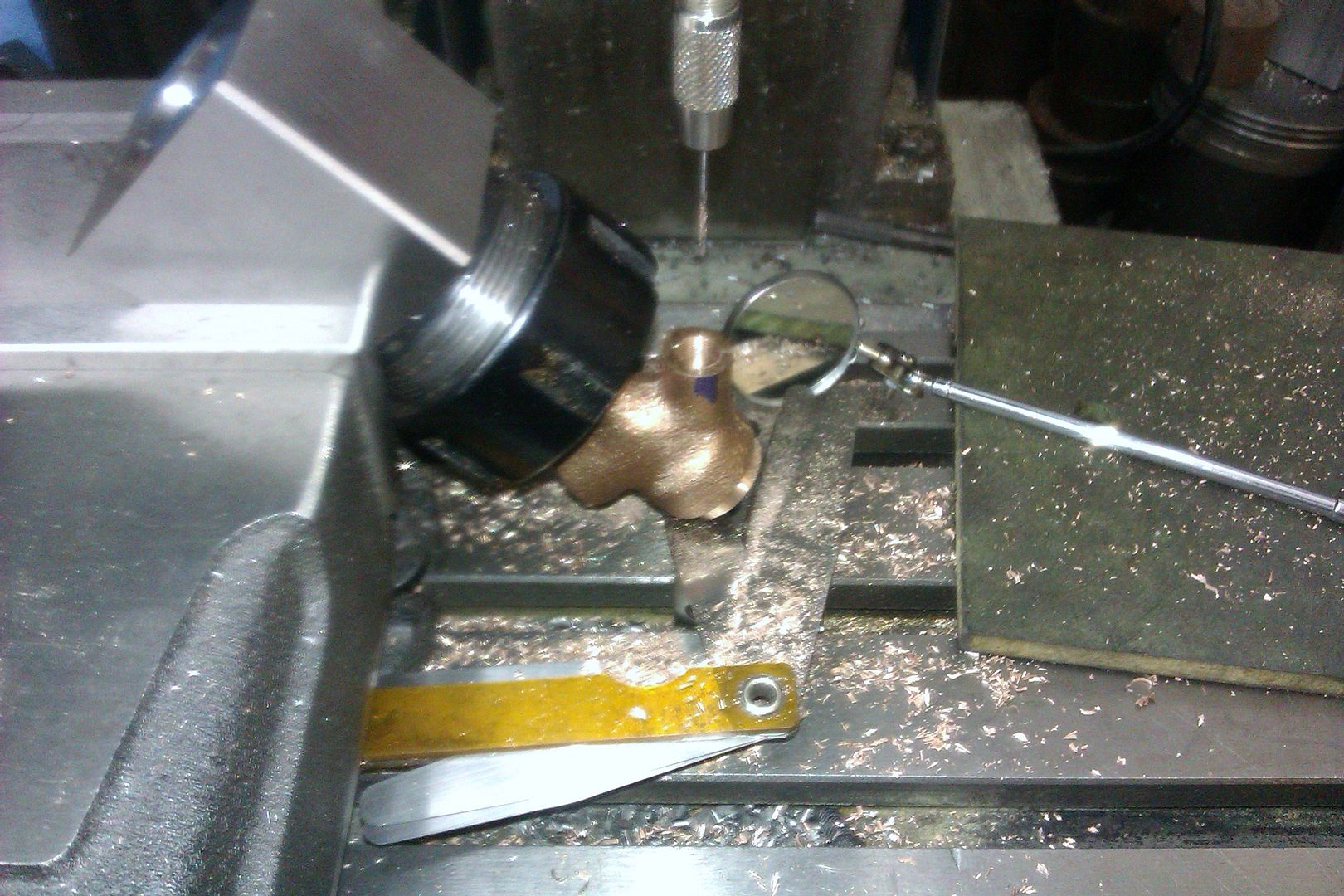

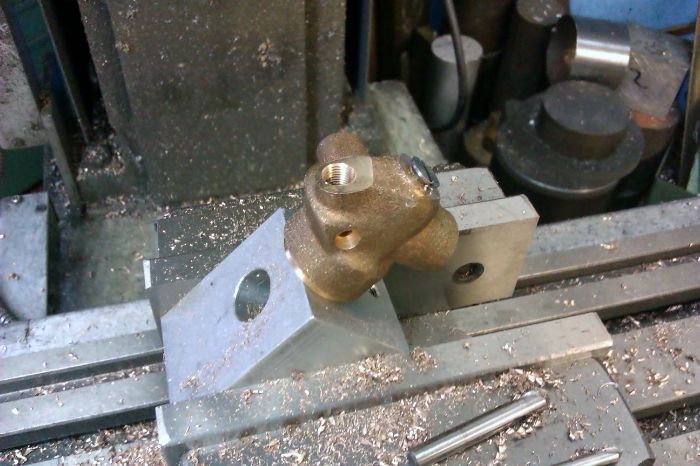

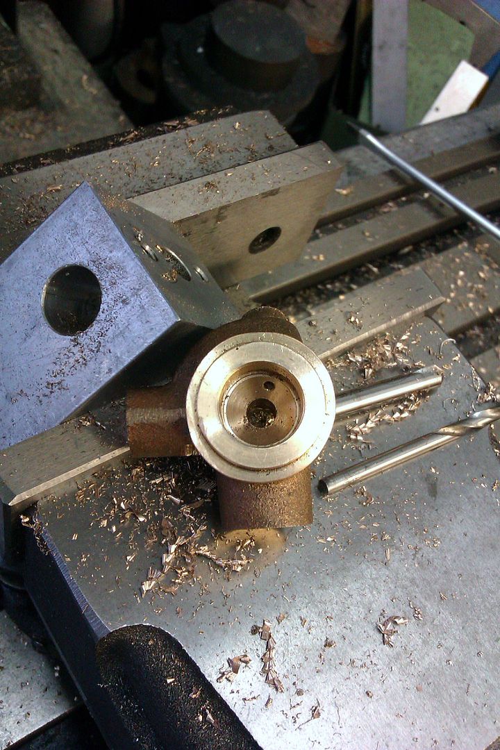

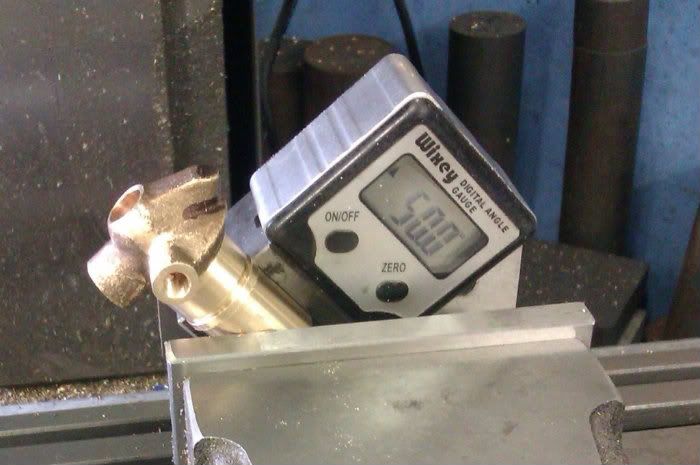

The show stopping trick may be as you say, drilling the fuel hole into the seat.
I am not sure how you would do that without breaking off some tiny little micro drill bit.
Anyone drilled tiny holes before? How do you approach that?

I still say that the trick would be drilling that fuel hole. I would not start to make a casting without mastering drilling some tiny holes first.

I have mounted a dremel on my drill press at times, and that would perhaps give enough rpm for a small drill bit.
