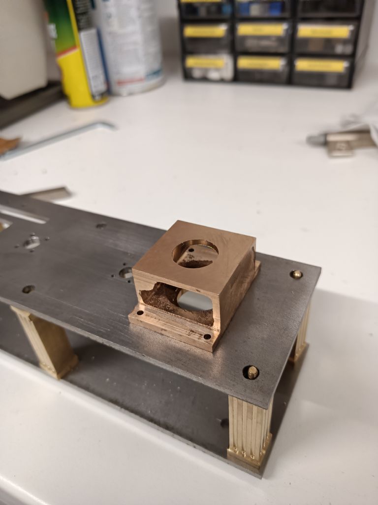

Anyway. today was the day of the cylinder pedestral. I am quite far, a few holes and threads are missing. But the main dimensions are there and the important flange and hole are done. Should be all straight and level. There are a few traces from the milling which I will file away.

Played with the upper columns today, produced one exactly according to Tubal Canes plan (16 flutes) but I do not like it. the flutes are touching, you get a sharp, cog wheel like structure. May be this is like it was in the past, the flutes were made for strengthening the cast column.
I made one with 10 flutes to see how it looks.
On the photo: square, 16, 10 flutes
I prefer the 10 flute look, so I made six of those. Enough flute milling. My right hand hurts...
Holding the workpiece was a bit tricky and needed a few shims. The top of the column needs to be horizontal, but the column has a taper... I saw some clever tools for that, but I don't have one. So I held it on one side in the chuck of the rotary table and on the other side in a small machine vice. Disadvantage is that you have to open the vice every time you need to change the position for the next flute...
Anyway, they are done. The ends on both sides are still too long, I made them longer to avoid problems of running with the clamping nut of the mill into the chuck of the rotary table.

Short update. The upper columns and their pedestal pieces are ready. Of course I needed to put all I have together. The screws on the top will of course be changed to something nicer.
The entablature was slightly warped, but easy to correct. What is interesting is the change of hardness in the casting. You find everything from soft as butter to hard as a rock...
