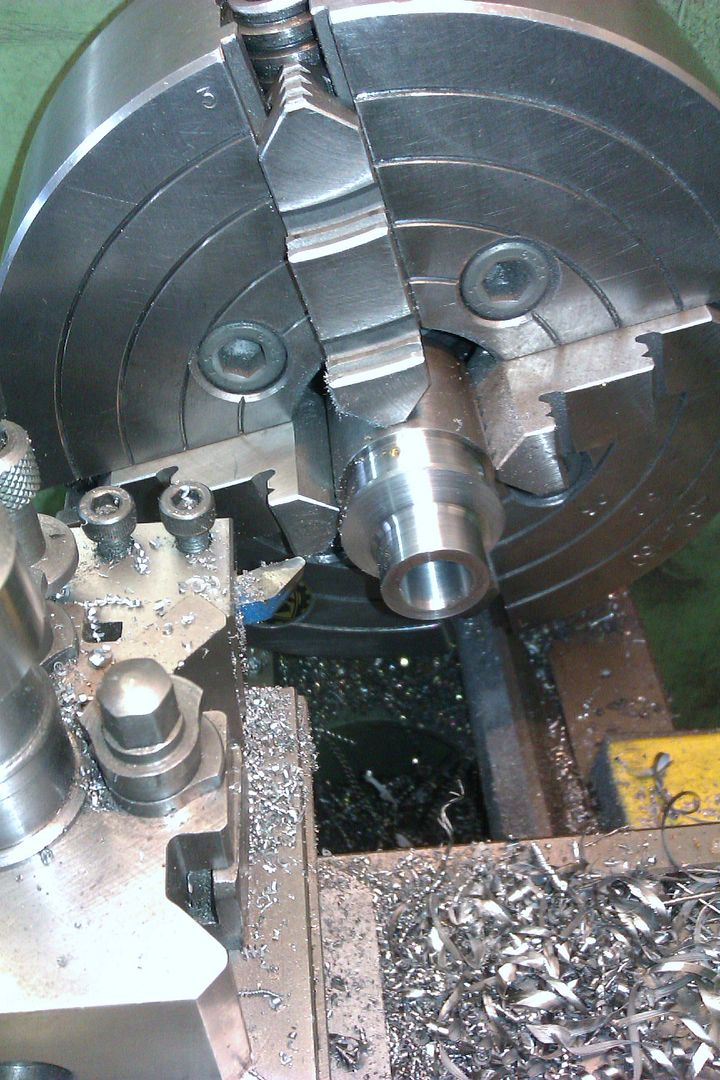

I use CCMT/GT inserts which I believe (could be wrong) only come in .04 and .08 tip radius. I have a job where a 1.2mm radius would be ideal but are inserts available at that size, I appreciate if they are available it would probably be another type of insert which would need a holder to suit. I have been searching but havnt found anything unless I,m looking in the wrong places.

Well the MRMN 1.5mm radius inserts and holder arrived, unfortunately the inserts dont fit the 8 x 10mm holder I ordered. Apparently the holder I have only takes inserts up to 1.0mm rad, for the 1.5mm inserts the smallest holder has a 16 x 16mm shank which is too large for my lathe. So I could get the larger holder and reduce the shank to 10 x 10mm or try to modify the small holder which would need the insert seat increasing in width by 1.5mm or drop down to the 1.0mm radius inserts though I would prefer to go with the 1.5mm.

I am going to try and modify the holder which will need the bottom seat lowering by 1.5mm using a carbide cutter I,m thinking it should cut ok. The seat is V shaped so after removing the 1.5mm, angle cuts each side should re-produce the V, well thats the thinking.

Mart, I have considered getting the 16mm holder and reducing the height but with the holder I have only needing the bottom seat lowering by 1.5mm I think it worth giving it a try. Providing it cuts ok it shouldnt be too difficult to do.

Well the holder was easy to modify and impressed with the insert whilst cutting the 3 degree tyre angle on a test piece.
