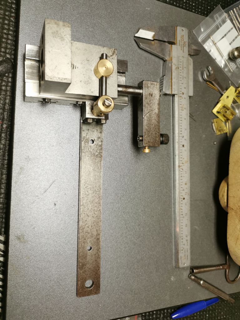

This came in a box of bits I bought at auction.
Anyone know what it is or what it's for ?

This is the range of movement
To this
Neil KilBane29/12/2021 00:29:53
12 forum posts
34 photos
This piece holds a small insert
That has a screw to hold it in place and a hex screw to set the depth of the insert.
Rob McSweeney29/12/2021 04:17:29
98 forum posts
Shop made taper turning attachment?
John Paton 129/12/2021 08:31:36
avatar
327 forum posts
20 photos
For scribing graduation lines on feedscrew dials?

Neil KilBane29/12/2021 12:14:51
12 forum posts
34 photos
Posted by John Paton 1 on 29/12/2021 08:31:40:
There doesn't seem to be any scribe or point to make a line, the insert in the piece is a hollow divit.
Neil KilBane29/12/2021 12:41:34
12 forum posts
34 photos
The T slots seem to be imperial if thats of any use, the T width being 1/2" and the slot 1/8" high. The groove is 1/4" wide.
Chris Gunn29/12/2021 12:47:48
459 forum posts
28 photos
The piece with the tee slots looks like a Myford cross slide, I would go with a taper turning attachment too.

Howard Lewis29/12/2021 21:30:37
7227 forum posts
21 photos
A Slotting Tool, to produce keyways, perhaps?

Thomas Jason31/12/2021 14:22:31
2 forum posts
Seems to be a tool for alignment
