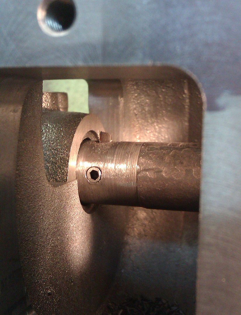

William Harvey 103/10/2021 10:21:53
176 forum posts
Quick question.
How much material can I safely leave in the tool head below the tool bit, without it fracturing?
Here is a pic showing the centre of the 5/16" bit being positions 14mm from the base - this leaves 10mm below the base of the tool bit:
And another showing the central hole being at 9mm which leaves 5mm below the tool bit?
As mentioned tool is being designed to cut very shallow depths, but what if I wanted to say use it to enlarge the valve throat. Obviously I would be restricted to bottoming out on the base of the throat.
JasonB03/10/2021 13:02:46
avatar
25215 forum posts
3105 photos
1 articles
the 9mm should be fine
William Harvey 111/10/2021 09:07:10
176 forum posts
Posted by JasonB on 03/10/2021 13:02:46:
Done - well the tool holder at least
According to one of the cylinder head modification guides I am using, I need to put a radius on the bottom outer edge of the cutting tool of 0.040". This will ensure that the corner of the chamber will not be has a sharp edge.
I guess I just touch the corner of the tool with grinding wheel to achieve this?
