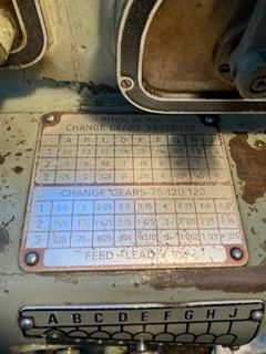

laithe 20201.jpgHi everyone. I have been enjoying my Smart and Brown Mk2 laithe which I have restored bit now I want to learn how to cut thread.
I just need a little bit of guidance. I do not understand the gear chart. Eg If I wanted to cut 1.5 mm threads it gives in the F gear 1 is 1.5 which I think is the thread I am wanting to cut. 2 is 0.75 no clue and 3 is .375 and i haven't a clue.
Any help explaining the gear chart would be much appreciated.

It sounds like your F gear position on the gearbox give s3 ratios. The middle one is 0.75mm pitch, one of the other positions doubles that yo by 2:1 so you get 1.5mm pitch and the other position halves it 1:2 so you get 0.375mm pitch.
Put F into the one that corresponds to 1.5
Assume you have any other levers or change gears positioned as required
EDIT Now you have posted the photo you will need to put the lever that has positions 1, 2 & 3 into the correct position and also make sure you use the gear train at the top of the chart section and finally move the lever under the chart to the 1.5 position(f).
<>Looking closer at the chart the upper set of gears use1, E Not F or the lower set of gears would allow 2B to be used. the 1-2-3 lever is likely to be bottom left of headstock

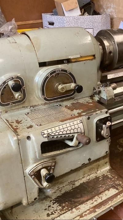

lathe xcx.jpgJason B So this photo is one I have in my album of my laithe which is at work and I am at home with a broken collar bone. So do I put the gear into 1 and the other leaver into E to get 1.5 mm thread? Sorry I am a real noob at this but very willing to learn. Thanks Mark

That's it 1E if the gears are as the top set of pitches, 2B if the second set of pitches
