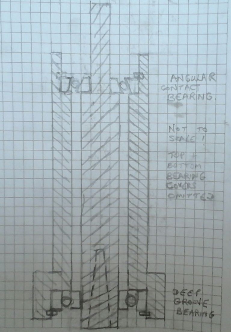

Hi All,
I am doing a tidy up of a drill press - a Qualters and Smith QDM 750 (backgeared, very similar to the Mk2 Kerry Super 8). There was noticeable play in the top spindle bearing. I have pressed out the bearings and am pondering re-assembly with replacements.
The bearing arrangement doesn't seem to provide for any way to control the preload on the bearings or even to ensure that the angular contact bearing at the top is actually taking the axial load. The inner and outer races of both bearings are press fits, with the outer race of the top bearing probably the least tight fit. I have included a (very) rough sketch below.
Any thoughts on how this was meant to go together would be appreciated.

Oily Rag17/08/2021 21:59:01

I also have a QDM750 which was gifted to me some years ago (because it had stood outside a famous (now defunct) car factory for many years and had been considered scrap). I rebuilt it and from memory the DGB bottom bearing acts as the locator for the spindle whilst the AC top bearing takes the axial load when drilling. The bearings which came out of mine were totally shot after being weathered and after cleaning up the spindle, the fit into the inner race of the top bearing was less than I would have preferred, Loctite bearing fit coming to the rescue - but it has all worked well enough. Which bearings did you fit as there was a late model change from the earlier bearings which, I believe, was a change to the tolerance class? Never seen anything definitive on this but was told this by a reputable M/C Tool rebuilder.
Have you managed to find an operators manual for it? The Tony site only provides the advertising literature as seen in the write up on the QDM range of drills.
Lovely bit of kit by the way.

James G 117/08/2021 22:49:59
10 forum posts
1 photos
Hi Martin!
Thanks for your reply.
I've yet to order up some bearings. The AC one is marked 7302B and the DGB one is 1 x 2 1/4 x 5/8.
My thinking currently is to fit the AC bearing to shaft and housing, and then press in the lower bearing (supporting inner and outer races of both bearings evenly).
I guess what I'm wary of is that there will be some room for the outer race of the AC bearing to slip upward under drilling forces until it takes up any small clearance between the bearing and upper circlip. This would leave the AC bearing relatively loose and would leave the DGB carrying the axial as well as radial load ?
Maybe I'm overthinking it, although it would account for the slop I saw that convinced me to press out the bearings.
J.
Oily Rag19/08/2021 18:21:59
avatar
550 forum posts
190 photos
James,
Sorry for the delay in responding.
I have now had a chance to dig my workshop notes out on this rebuild - unfortunately I no longer have any photographs (the curse of mobile phones that get broken, lost, or stolen!) but from my notes I measured the distance between the bearing shoulders of the spindle quill and also the depth of the retaining circlips, the upper (AC bearing) clip gave a +0.004" clearance on bearing outer race width. I did consider packing this but eventually settled for 'as it was' condition.
The way I see it the AC bearing supports the mandrel and the lower DGB 'floats' to accommodate the upper bearing. I used a Hoffman RLS8-V3 DGB and a SKF 7302 BEP AC. With it all assembled the end float was zero - I believe the end float you have experienced may have been caused by the AC bearing wearing through lack of lube, this will introduce end float. I would certainly recommend you check the gap between the top retaining circlip and bearing to ensure a close fit. A spring 'wobble' washer could be used if it is excessive. Also worth replacing the circlip if it is damaged in any way.
Let us know how you get on.
Have you any response about a manual?
Martin
PS - my method of assembly was to press in the AC top bearing into the quill, then supporting the inner race of the AC press in the mandrel which had the DGB bearing pre-fitted to the quill shoulder dimension, when the DGB outer race was ready to go into its housing I tapped it in gently as the mandrel was still under load. The upper bearing was as I said in the earlier post an 'easy' fit due to the corrosion from being in the elements. The drill has been fine with a very quiet spindle and no overheating.
Edit for PS
Edited By Oily Rag on 19/08/2021 18:31:05
old mart19/08/2021 19:30:29
4655 forum posts
304 photos
It does look strange but being a drill, there should be none of the sideways forces associated with a milling machine spindle.
James G 122/08/2021 20:08:01
10 forum posts
1 photos
Much work later.. more knowledge but not entirely happy.
First off, there is very close to 1mm of extra depth in the top housing over and above what is required to take the bearing and metal dust cover. I have a washer made up to take up this gap. I think it is a fraction too tight at 1mm for the snap ring to fit perfectly so I may thin it/re-make it .
I then fitted a set of bearings (import 'Zen' branded). With the slop taken out of the top bearing, the lower bearing was running unpleasantly hot at the top speed. The top bearing was fine temperature wise. Cue another disassembly and the loss of the newly fitted bearings.
The disassembly threw up another nasty - I went to drive out the bearings from the top down. The inner race of the AC bearing pushed out of the outer race, but it brought the balls and cage with it. The balls then started to impact on the shoulder below the bearing. I stopped once I saw what was happening and ended up driving the bearings out from the bottom. The balls had raised a couple of dings on the shoulder which I dressed out. I had used the technique of driving out from the top when I originally dis-assembled it, and on that occasion, the inner race of the AC had moved down, leaving the balls in the outer race where they could do no harm. So it seems like it might be the luck of the draw.
James G 122/08/2021 20:33:49
10 forum posts
1 photos
The lower bearing was sitting on a shaft which I measured at about 0.015 to 0.017mm (say 6 tenths of an inch) oversize. Then, the outer housing is also an interference fit which I reckon all makes the assembly process more demanding and is probably significantly reducing the clearance in the lower bearing.
I took the shaft down to 1 or 2 tenths oversize (by hand with 400 grit paper). It actually went marginally under in one spot but overall should still grip well I think. I also gave a minute or two smoothing the housing surface for the lower bearing - I don't have tools to measure the bore but it was still certainly an interference fit.
Then I fitted new bearings. I applied a slight pre-load by lightly tapping in the outer ring of the lower bearing as a last step. This definitely takes the slop out of the upper bearing. There was certainly a temperature rise in the lower bearing but more acceptable.
The next problem though was the appearance of a new noise from the pulley/spindle interface. I suspect that either a) wear b) misalignment or c) a slight bend in the spindle was being 'tolerated' by the slop in the top bearing.
At that point fate intervened and the spindle slipped and dropped square on the table. This shifted the lower bearing slightly downward I reckon. Cue return of some slop in the top bearing.
Around this point I fitted it all together and for now have cut my losses.
It's all certainly running more quietly and smoothly than before. Some day maybe I'll go back to it.

Oily Rag28/09/2021 12:11:49
avatar
550 forum posts
190 photos
James,
I missed the back end of this thread whilst away on holiday. I see you had just under a 1mm clearance between the top AC bearing and the underside of the circlip. Is this possibly down to the 'Zen' (never heard of these before! ) bearing being undersize in assembled width?
When I was replacing my bearings I searched around for known makes - I was offered 'Charlie' bearings for around £8 to £10 each, but genuine Hoffman, FAG, or similar were priced around £60 to £70 each! This was from a well known bearing supplier based in Norwich. I then tried two local suppliers of Vintage bearings who both offered known makes for all 4 spindle and pulley assembly bearings for a total of £55 (and threw in new circlips for the price ).
Just for reference for other QDM 750 owners the pulley assembly bearings are:- Top bearing EE9 or KNLJ1 (1" x 2" x 3/8" ) and the lower bearing is a Hoffman LS25N or equivalent (25mm x 52mm x 9.3mm ). These are both narrow light journal open ball races of 3/8" width.

James,
Re-reading your earlier post it struck me that the alignment issue of the lower pulley bearing, which is held in a floating steel pressed cup, could be an issue. I realised the steel cup which holds the lower pulley bearing needed slackening off to allow the puller assembly to find it's own seating. In my notes on the re-build I had quite a job to get the spindle assembly to line up - and the overarm was not bolting down snugly: I had left the dowel pins in and tried fitting them in place, in the overarm, as I bolted the overarm back to the head casting - with the lower bearing plate loosened off I took the dowels out and bolted the overarm down lightly before lightly driving the dowel pins in from the top. This cured all the binding. There is a definite procedure to the build with these machines!
Another point to beware of is the bull gear detent pin can become locked if the latching plate overshoots whilst assembling the spindle pulley assembly prior to the bearings being pressed on.

James G 102/10/2021 10:17:47
10 forum posts
1 photos
Hi Martin,
Your point regarding the lower pulley bearing is well made.
I let the lower pulley bearing find it's own best alignment by removing the belt tension and gradually nipping up the mounting bolts, all the while rotating the spindle by hand to allow it to nudge the pulley into alignment. This is definitely a necessary step as you say.
I'm happy now with the pulley setup. The spindle bearings are noisy though. It may as I mentioned be the quality of the bearings themselves or my handling of them. If you could send me on the details of your bearing supplier it would be appreciated.
