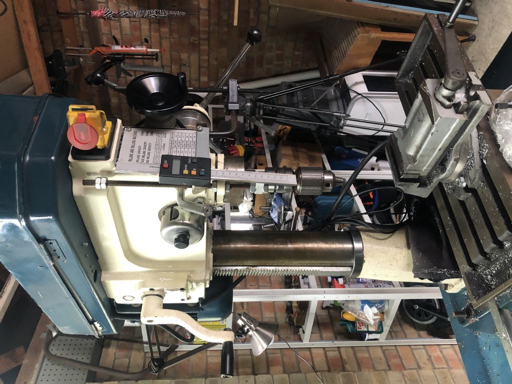

After 20 years of use and with spindle run out getting unacceptable, I decided to inspect/ refurbish the quill and spindle on my trusty Warco Major Mill/drill.......
I found some information on U Tube of course ....BUT...having stripped the quill control shaft , quill locking bolt and spring return and using a gear puller to remove the pulleys ( all very straightforward ) I then expected the quill to slide down for easy removal....?????
It doesn't...???? It stops as if there is a locking / restraining 'device' which I have missed...????? I have looked everywhere on the machine and can't see anything which could be stopping the quill from coming out..???
I have so far resisted the temptation to 'move' things with a copper hammer.
Any HELP on this will be greatly appreciated...

It's hard to imagine what might be obstructing it if it is free to turn in it's housing.. ..it'd be a useful thing to establish that we are talking about the same particular model of machine
This earlier thread contains a link to a useful section through the head (about 6 posts down) in an album belonging to Robbo, as well as one that links to the Grizzly G0705 manual which looks pretty much identical to my machine..
Warco Major Mill/Drill
If you're able to post a picture of your machine and/or where you are 'at' with it, it might help to identify the particular model and maybe elicit some further responses..

mill start point.jpgYes I saw those docs and printed them off...
'Robbo' was helping Trevor Wilson and although Trevor appears not to have been on line for some time and there are no contact details for him , I have sent a 'help' message to 'Robbo'....

Hi Terry Turner 2, looking at the photo of the milling machine that have posted, I would say it looks to be similar to the Chester Eagle 25 rather than a Warco major, which may or may not have the same configuration on the quill.
The Warco Economy is also similar Economy Mill
Regards Nick.

With thanks to everyone who has helped me, I have to confess that I accept what Nicholas Parr says..my machine is much more like the Chester Eagle 25 than the Warco...I bought it 20 years ago and my memory had played tricks on me ...not for the first time...
I will now go off and try and get information about the quill assembly for the Chester machines and hope that is the answer. Apologies for almost certainly wasting your time.

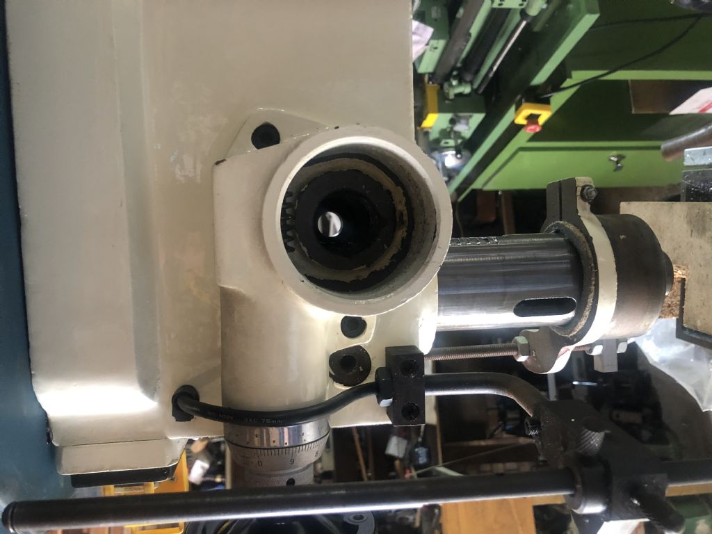

Thanks Old Mart......This picture will show that everything that I can think of that would stop the quill from sliding out has been removed and I used a gear puller to remove the pulleys so no damage was done to the top of the spindle....and the locking lever and anti rotation grub screw on the other side of the head have also been removed...? .. Please see pic..
I am now finding it very hard to get information about the Chester Eagle 25 which may hold the secret to the Quill design on my model...quill shaft housing.jpg

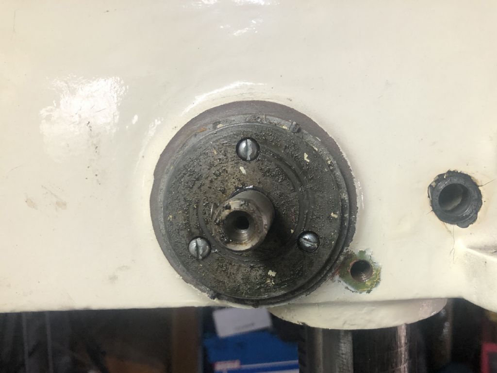

Your photo shows the depth stop still in place, have you removed the adjuster screws? Also, the fine feed for the Zaxis is still in place (2 socket head cap screws), I removed that on a similar mill, although that may be clutching at straws. Removing the pulleys would, as far as I remember, have no affect, as the centre part with the female splines would still be in place.Your spindle is empty, I presume?
Edited By old mart on 04/08/2021 21:37:24

Sorry that picture shows the drill stop but I removed it and everything else on the head with could impede the quill . The quill and spindle both rotate freely but will not slide out the bottom of the head like every other mill of its type I have seen stripped on U Tube...? You are right about the pulleys but I wanted to see what , if anything, was underneath them... Thanks for responding...

Push the quill up as far as it will go, and examine the top of the spindle to see if there is anything stopping the splines from passing through the drive that the pulleys were on.
