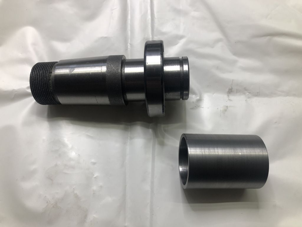

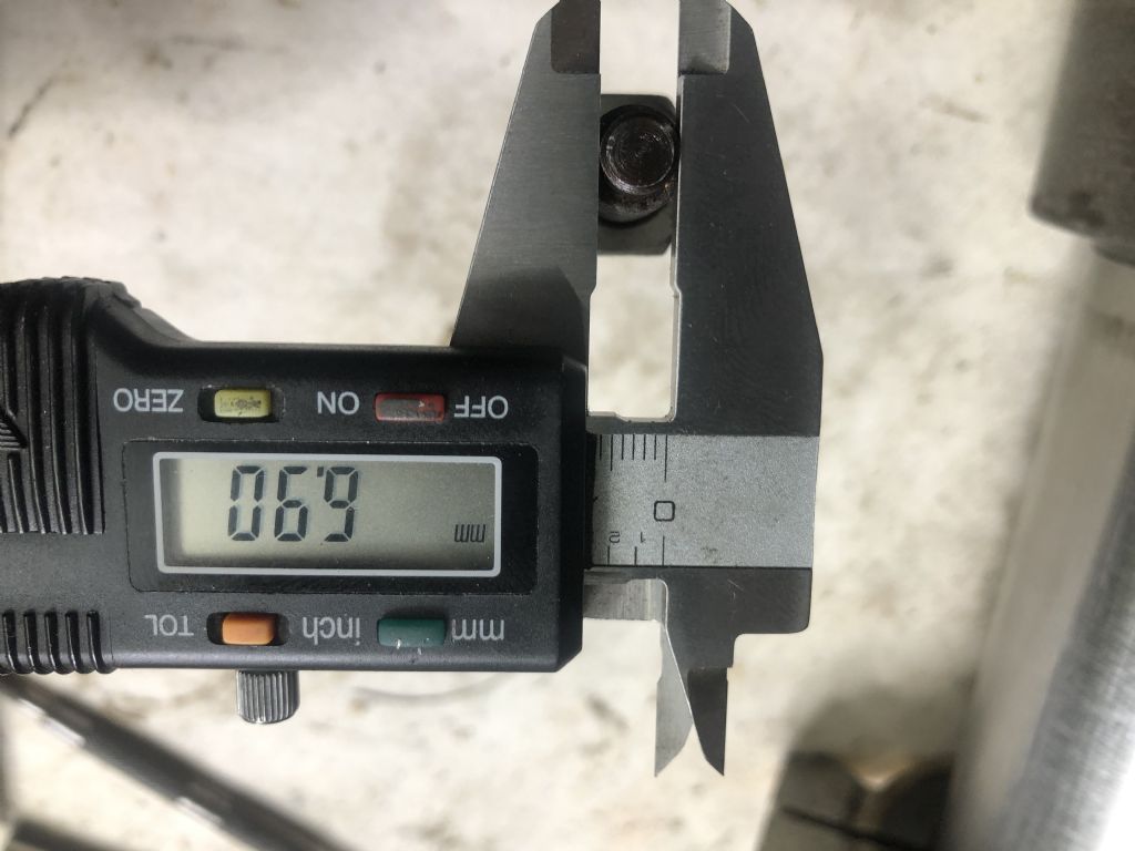

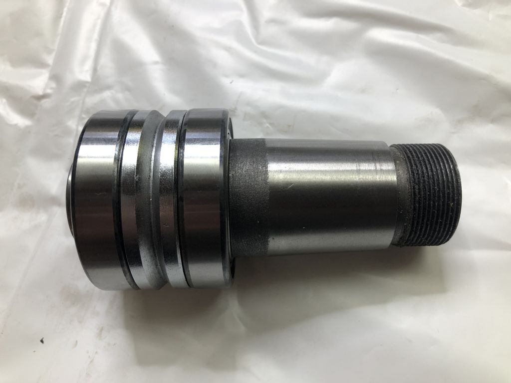

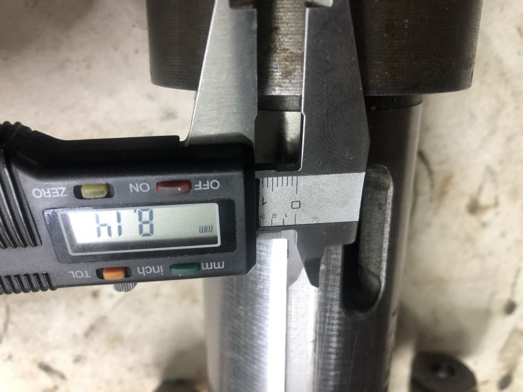

I have all four new bearings for the quill /spindle and the pulley shaft.
Whilst I was waiting for them ( 1 hour from a very local distributor ) I turned up a new anti-rotation ( 10mm ) grub screw as the original was very ill fitting.
anti rotation groove.jpganti rotations screw size.jpgSorry they pics appear upside down but you can see that a 6.9 screw will be very sloppy in a 8.14 groove.
I then turned a sleeve to fit the pulley shaft bearing inner race so I could press them on to the pulley shaft without any fear of distortion or damage.
pulley shaft sleeve.jpg img_9777.jpgThe pulley shaft bearings / shaft are a snug fit into the top of the head, ensuring that you don't set them too far down in to the head ( there is no seating ledge) and feeling/ setting the grub screw on the side of the housing so that it is positioned in the groove in the bearing spacer.

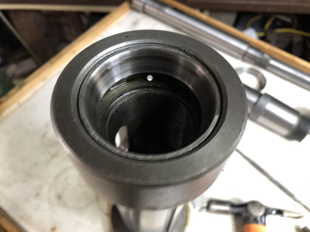

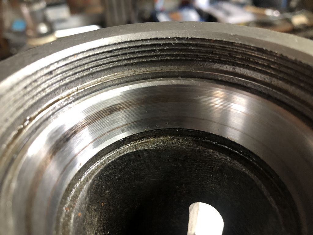

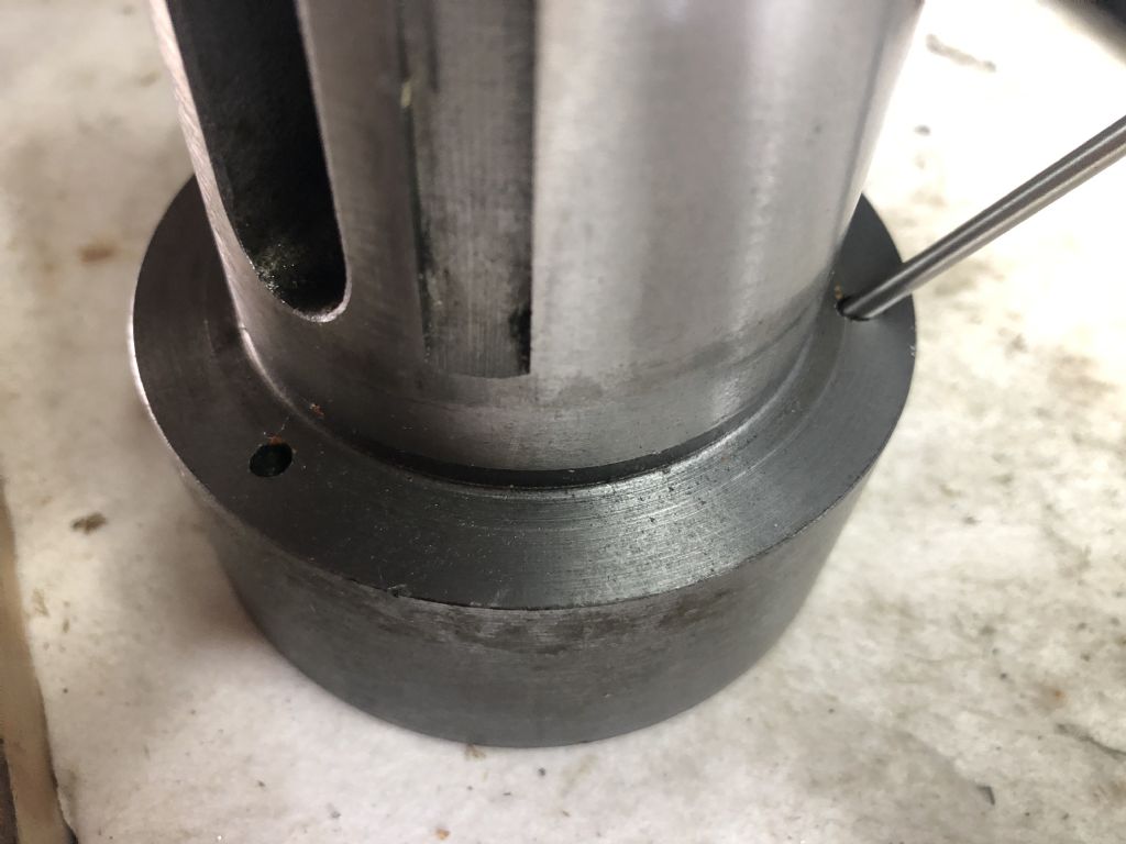

08/08/2021 18:55:28
Chester quill bearings.
I missed something again....!
The lower taper bearing race has a pronounced lip protruding into the ID of the quill so it was easy to remove..
I turned a cylinder the ID of the quill , ( it is a rough casting so a loose fit was all I could achieve) I then dropped the cylinder into the quill so that it sat evenly on the bearing race lip and a sharp tap with a drift removed the seat without any distortion / damage to the casting.
The upper quill taper bearing race is a different 'kettle of fish'.
There is no protruding lip and the bearing is completely enclosed within the housing.( see pic )
I could not imagine what kind of engineer could create such a design...?
I thought long and hard about the options and eventually decided that some more thinking time was needed and stood the quill up on my table ( I normally lay it down) .......THEN I NOTICED.....three small holes in the exterior/ reverse side of the bearing housing.
The holes are 3.5 mm did so I put a piece of rod into one and found it was a 45 degree hole which obviously led to the back ( inaccessible) part of the bearing .
Tapping each in turn loosened the bearing and moved it enough for me to get a drift in and finish tapping it out.
I now understand that it is quite a common practice to provide such access holes but I have never come across them before and the fact I didn't notice them has reinforced my reputation for having poor powers of observation. ( You will remember that I missed the bruise/ burr on the top of the quill spines that caused me so much trouble )
